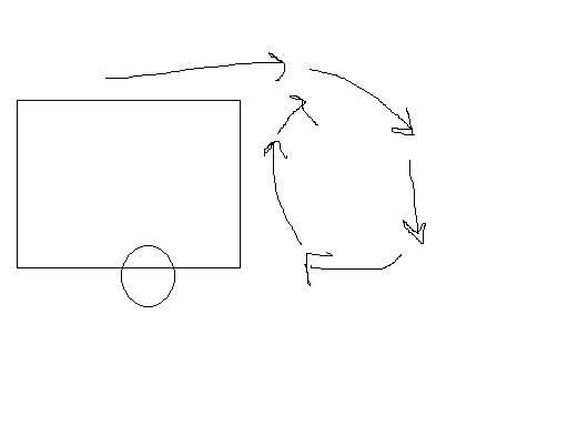

very true but the question would be the function behind this piece... im not too concern over downforce as a FF don't really need rear downforce as much as a RWD car... question is will it clean the air going under the car, so my question is will this clean the 'dirty boot' syndrome that is almost garenteed in any hatchback/wagon/SUV design

the dirty boot syndrome is actually caused by the fact the air drops off the roof of the car rather than getting carried down by a trunk. the induced turbulance of the air is such that it swirls behind the car in a pattern like the attached pic. it might help with redistributing the airflow after it has gone over the ground (maybe preventing it from carrrying dirt from the ground straight up), but the air under the car is not what causes the dirty boot effect
