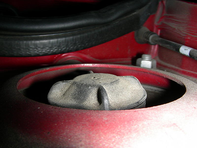

Originally Posted by hoonpv
...i checked the top of the strut mount, where you pop the cap off to reveal the hex nut, the entire rubber assembly is noticeably higher than the passenger side...
The bearing can punch through the encasement without cracking the rubber up top; replace the guide support. To verify, turn the guide support upside down and compare with the other support for thickness, it will show signs of separation around the bearing sleeve edges on the bottom. Also, the early model (R53/50) guide support rubber encasement is flat on top, and the bearing rides a little higher; the later version for the same model (R53/50 etc.), is dished with a conical neck around the bearing, you could have a different guide support version between sides if it has seen repair before.
Attached Thumbnails Suspension :: Springs Install How-To-dscn2373.jpg   Suspension :: Springs Install How-To-dscn2346.jpg
