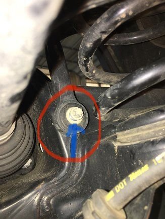

So I installed this exact setup on my wife’s f55. Couple weeks ago I started to get a rattle from the rear. Today I found time to look under the car and noticed the bottom bolt that fastens the aftermarket swaybar link is missing. Anyone know what size the bolt is or the part number for it?

realoem.com for part numbers!
Sway bar installs require recheck and torque after a few hundred miles, as I found out when everything loosened up.
Along with loctite red
