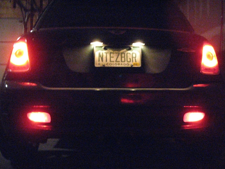

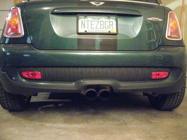

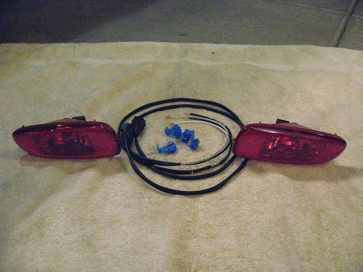

Just finished the install. Not hard at all. I got the Rear Lens Kit from OutMotoring and the Add a Brake kit from GoMiniGo. I think it makes the rear look more finished.
The parts:
Before: (its not really as dirty as it looks - its reflections - really)
With lights out:
All done:

The Rear Lens Kit from OutMotoring was $59 and the Add a Brake kit from GoMiniGo was $34 plus shipping on both.
As requested here is a shot with the lights on:

Its a very simple install. The fill plugs just snap out and the new lights snap back in. You will need to remove the tail lights, but even that is easy. Once you take the chrome surround off (just follow the instructions), there are some screws that hold the lights in. Run the new wires and put the lights back in place. The kit even comes with the wire connectors and bulbs for the new lights, so you will have everything you need for the install.
