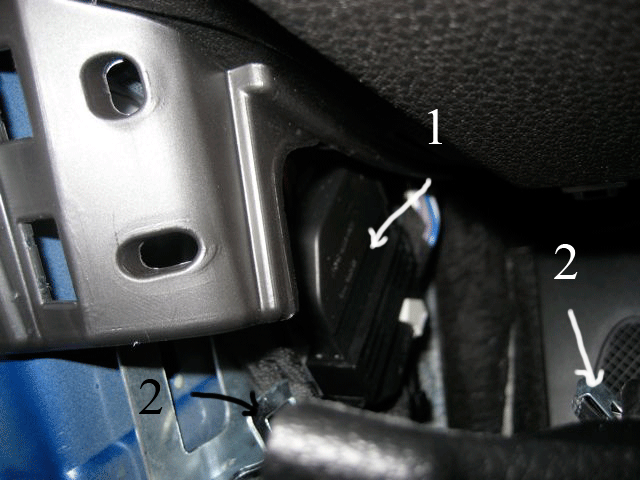

I did the channel swap this afternoon, I haven't even had a chance to listen to it yet (other than to make sure it actually still played music), but I do have a couple things to add.
I also had a hard time getting the connector loose from the wall, but I got it to reattach easily. Point 1 in the image below shows a black connector. The x9113 connector is attached to the left side of the black one. On the other side of the x9113 connector is a white plastic piece that holds the assembly to the wall of the car. It has a rectangular tab on the back, and there is a rectangular hole in the wall of the car. The tab fits easily into the hole. It doesn't snap in. What holds it in place is the relative orientation of the hole and the tab; the tab is rotated relative to the hole after it is inserted into the hole. The hole is at an angle, and when secured, the tab is horizontal. If you try rotating the connector (1 in the image below) in a counter clockwise direction while pulling out, it should come right out.
I had a couple other problems. The mod thing took me a really long time. I'm not sure when I started, but it took at least an hour and a half. The lower black panel actually broke at one of the christmas trees when i pulled it out. It broke where the christmas tree attaches, so it won't hold the christmas tree firmly. bummer! I even had trouble getting the male and female halves of the x9113 connector apart. Probably because of all of the good advice here, it was pretty easy to remove the back part of the female end of the connector, pop the pins out w/ T20 and swap them. This was the easiest part.
The other problem I had was getting the lower black panel back in place. In the image below it looks like there is a slot and a piece that should go in the slot, but for the life of me I couldn't get them together. Does anyone know whether these parts labeled 2 below should fit together?
