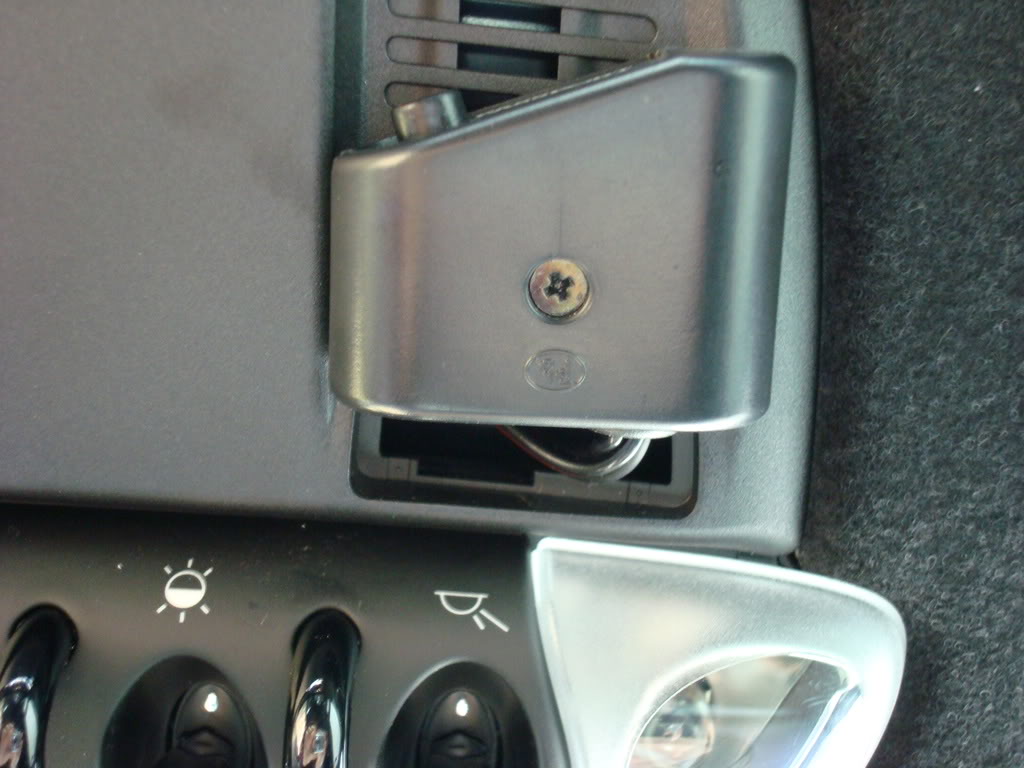

Thanks to crucial fiction for the DIY. Followed the instructions and it was very easy.
Here are some pics I have after the job just to give people ideas. I mounted the 9500i with a remote cord.

Nice job. I would be tempted to cut a hole in the overhead console to fit the Smartcord somehow. Don't let me near your car. I've drilled one to many holes in mine. Does your 9500i rattle against the rear-view mirror?
