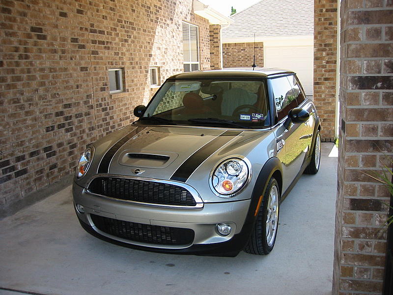

back on the road
Yes, so far the MINI drives fine & seems normal.
I appreciate all the replies - very helpful.
It is clear that pretty much anyone you call will claim they can work on a MINI, so beware. The Mobil guys told me they could do it, but the poor guy they sent was stumped when he saw it. I cannot believe 1 transmission shop told me to take my oil back to the dealer, that their 'stuff is better'. & I am pretty sure I called a local # in Texas when another major shop proudly stated 'we work on all domestics, so bring that MINI Cooper in'.
Hopefully no 1 repeats my cascade of mistakes.
Just remember for U.S. automatics '07 & later, the engine oil drain pan is on the passenger side with no sticker & takes a T50 torx bit or 8mm hex key, & the transmission pan is on the driver side with a sticker: "Warning: Lifetime Oil" & takes only a 5mm hex key.
& if you get in over your head, going to a dealer will get it done right.
Attached Thumbnails Maintenance :: Cooper S Oil Change (with pics!)-mini-3.08.08-1-.jpg

All's well that ends well, I'm glad for you. Nice looking car, too.
