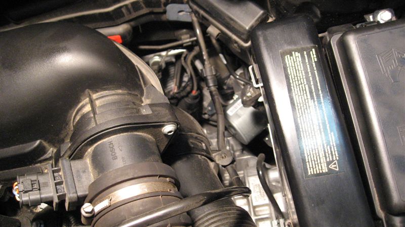

picked up a T-50 Torx bit from Sears Hardware. Loosened the 'engine' oil pan drain plug 2 turns, and watched my oil level readings drop from 2.5", 2", 1", then right under the max line before tightening. Oil recovery pan drain appears to have caught 4-5 quarts & took 30 minutes.
Ths first pic is a birds eye top view, looking down on the engine. Note the canister above the transmission.
The 2nd pic zooms in to left of the canister, showing the bolt right below it. This should be the transmission plug to pump into. Anyone know what size bit to loosen this?

T-50 Torx works for Drain Plug, but 8mm Hex is the proper tool, remember to remove the old and install the new copper Crush Washer
(first one is often held by paint and hard to see on new autos).
I don't know the tool for the tranny fill, but I had bought both the T-50 & 8mm Hex at Advance Auto for my oil drain.
A careful 'finger tight' test on my Drain Plug showed which one was a loose fit and it was not a problem to return the T-50.
I would suggest purchase of several likely Torx, or more likely Hex bits to find the right size and then return the un-used ones.

If the ground is fairly level you do not even have to jack up the car. The oil plug is accessible from underneath the front of the car and an oil pan will easily fit under the drain plug unless you have lowered the suspension on you mini.

Transmission refill plug
Looks like I should have asked the Parts guy at the MINI dealer how to actually top it off the transmission oil, as the Mobil Mechanic guy could not find a refill plug. He mentioned it looked sealed, as every bolt appeared to hold the innards in place. I tried calling the dealer this afternoon but no answer, they must have closed early.
Yes, I saw their advertisement in the Yellow Pages & had hope b/c they displayed the BMW logo.
I'll try calling the dealer Sat morning & try to ask the same parts guy.
I might as well also order this DVD on Ebay:
Mini Cooper S D One Factory Repair Service Manual 01-07 $11.19
Technical Information System Factory Service & Repair Manual on DVD
For all engines & trims!!!
as it claims to cover automatic transmissions. In fact it covers so much you could open your own BMW/MINI shop. Surely it will show where the refill plug is?
Has anyone else actually added transmission oil to their automatic MINI Cooper year 2007 or later?
If so, where is that sucker & how do you access it?

i don't have an automatic but if i had to make a guess... I would guess #7 in the parts diagram in the link: http://www.realoem.com/bmw/showparts...63&hg=24&fg=15
I believe I am correct but it's not my car so I can't be 100% sure. I'm reasonably sure since it's above the transmission oil pan and it has a crush washer, while the others do not. Good luck.

I think #7 is the drain plug, I think #6 would be the fill plug

Yes, and on the same site; showing Pan, Magnet and filter:
Sounds like a bargan on eBay as the MINI Online site is
$30 for 24 hour access and for transmission; they say:
MINI does NOT support technician rebuilding of its transmissions,
only limited repair and service, for example seals, gaskets, and sensors.
Therefore, only limited transmission service information
can be found at any MINI-authorized source, including this website.

#7 can't be the drain plug. the link does not show the actual bottom of the transmission. the bottom shown in the picture is actually the top of the transmission pan. thus #7 would not drain any fluid.
also on a side note, it looks like you can't over fill the transmission either, as there is what appears to be a tube that will drain out any excess fluid
:edit: looks like pilotart posted the two pics
