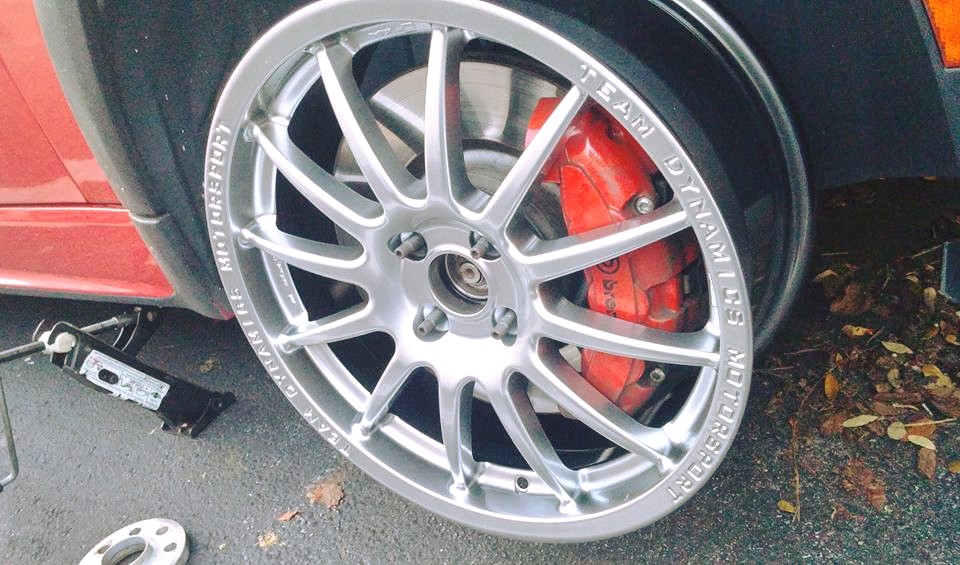

Team Dynamics 1.2 17x7 e38 +5mm spacers
These will also fit.

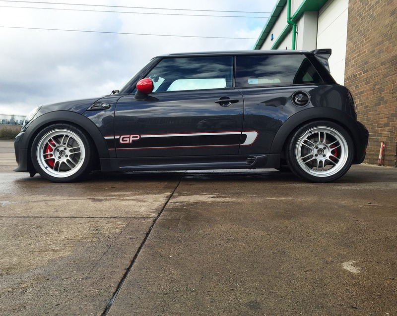

I have Enkei rpf1's on my GP.
17 x 7. ET 43. Currently using a 15mm spacer, but I will go smaller soon as the rears rub every now and then.
I did want ET 35 but couldn't find them anywhere.
