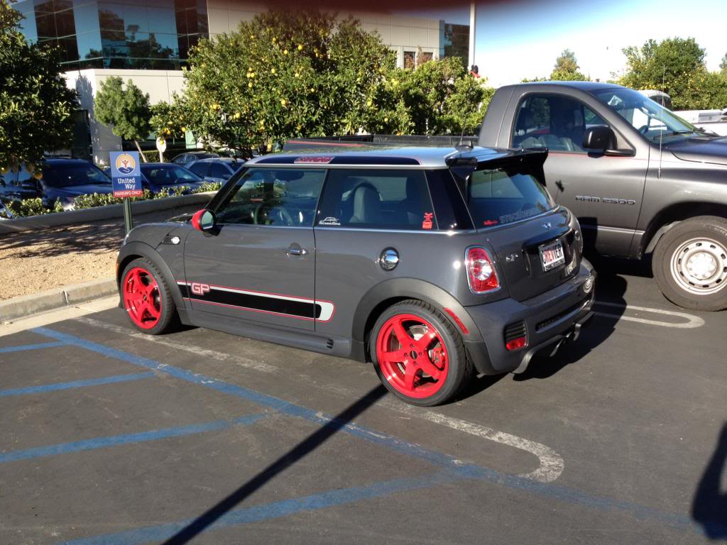

A couple pictures of my car GP 0468 with RED NM RSe05 wheels and NITTO NeoGen 215/40/17 tires.

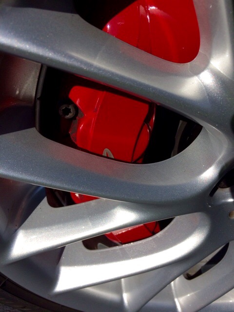

Team dynamic pro race 1.2 7.5x17 et45 give about 8mm caliper clearance.

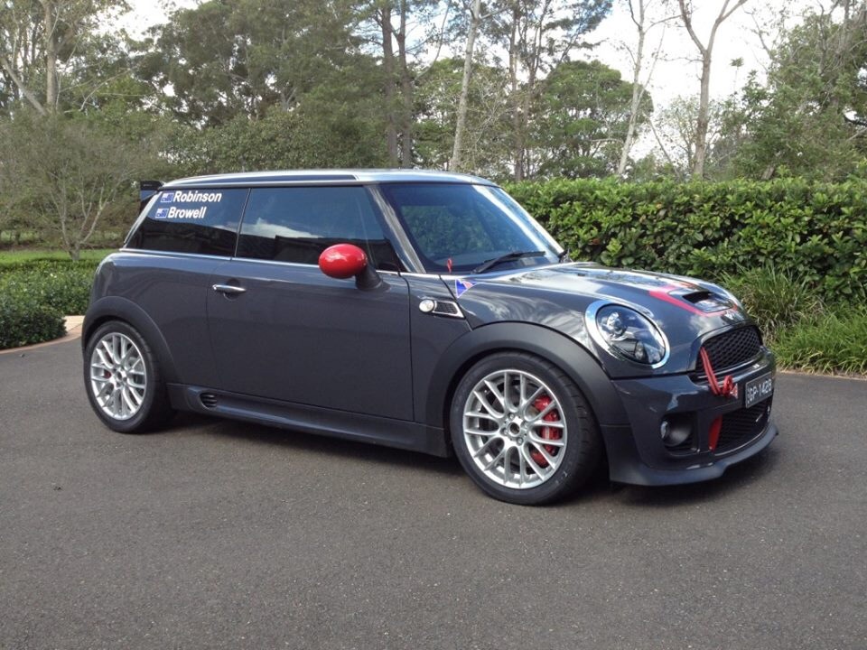

OZ Ultraleggera.... :) ON KW's She will be up for sale soon, tons of upgrades, Roll
OZ Ultraleggera.... ON KW's low low
She will be up for sale soon, tons of upgrades, Roll-bar.. :( wheels as well....will be open to offers .. PM any questions
one last pic before selling

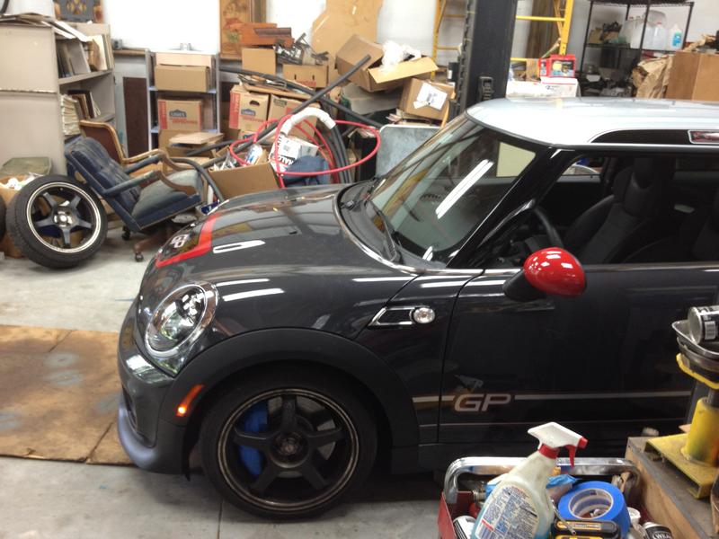

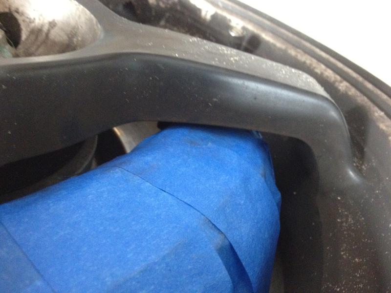

Stuck one of the wife's Kazera KZ-K's on the front of the GP this weekend to see if it clears - and it does. No spacer. 17X7.5 4-100 ET40 with 205/45R17 goodyear assym AS's. Coilovers at max height (thanks to the PO) - though dont see any obvious issues with lower. 215's might be a tighter fit. (215/45's on these rub the fender liners on r50/53)
(3rd time is the charm to get the picture right?)
Attached Thumbnails GP2 Wheel Fitment-img_0284.jpg   GP2 Wheel Fitment-img_0287-1-rotated.jpg

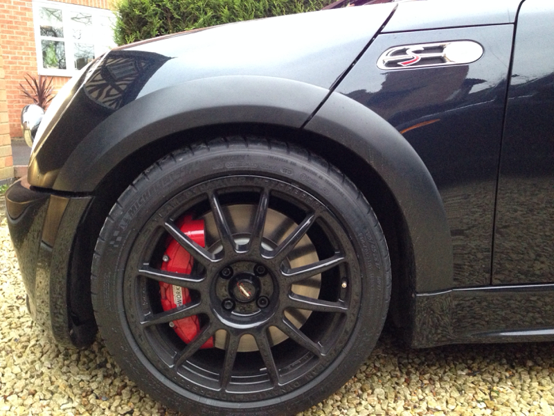

My GP on Advan RSII in 17x7 ET42. The wheel will NOT clear the front caliper without spacers. You will need at least a 6mm spacer.

As promised, OZ Records! (17x7 44mm offset, 215/45R17 goodyear asymmetrics)
6mm shims up front (stacked 3mm). 5mm was just too close for my comfort - less than 1mm gap to the rotor. Used the 5mm's in the back to keep the track width close.
Managed to take it out for a quick drive - man, nice to have good rubber under it! Those 400 treadwear sumi's sucked!
Attached Thumbnails GP2 Wheel Fitment-img_1023-rotated.jpg   GP2 Wheel Fitment-img_1024-rotated.jpg
