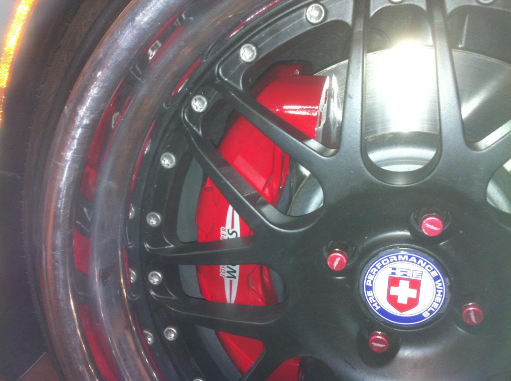

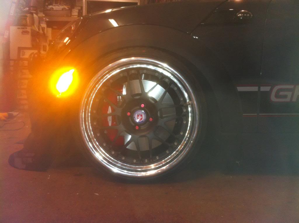

Test fitted my 18x9.5 HRE C20 wheels. Super aggressive and stick out too much for my likings and will be changing the outer lips- bringing them back to 18x8...but for the sake of this thread- HRE C20 faces clear the brakes

Airborne Ranger - nice job on picking your new rims. They fit the car nicely.
Have you considered tire options? I live in Maryland and will be swapping out the Kumho's before next winter for an all around performance tire that is better rated for wet/dry handling (without the cold weather restrictions).
Thanks (love our GP put 400 miles on it in 2 weeks)!

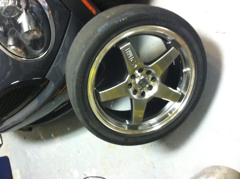

I have used Enkei EV5 17 X 7" with Hoosier 225 40 17 and needed 5 mm spacers for my 09 jcw and 10 mm spacers for my 13 gp. I think the offset is 47
Attached Thumbnails GP2 Wheel Fitment-image.jpg   GP2 Wheel Fitment-image-1-.jpg

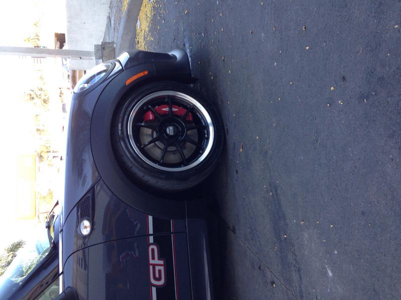

New set of 17" OZ Alleggerita HLT SE/ Dunlop Star Spec Z1
