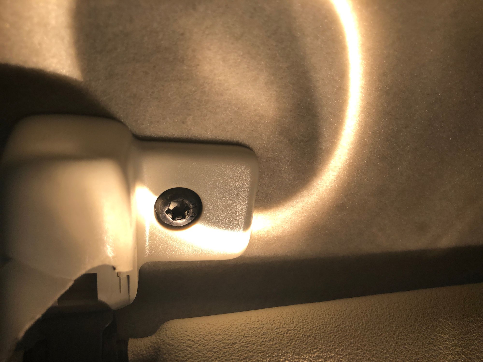

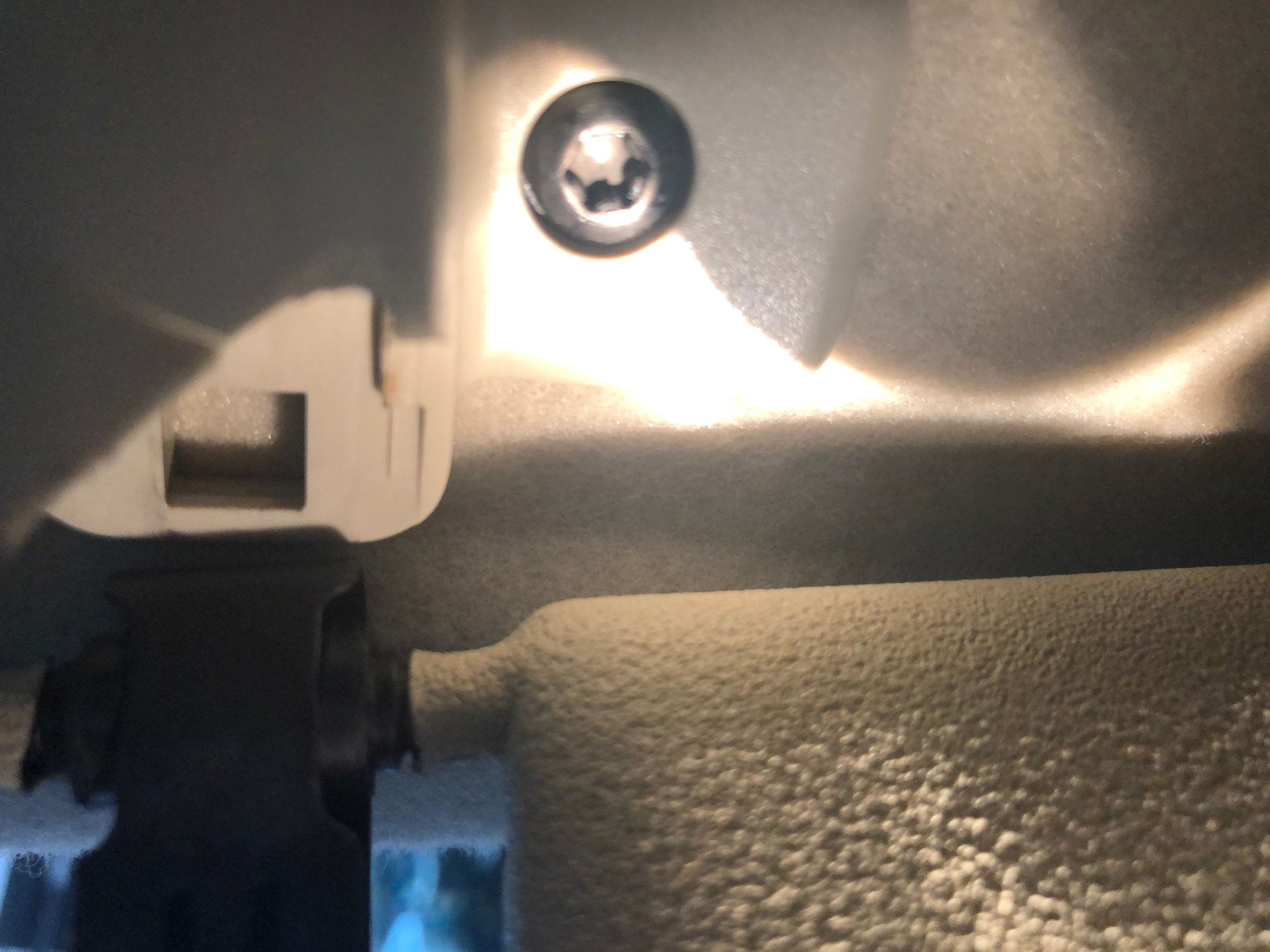

Replacing the tabs that hold my driver side window pull down sun shield.
I ordered and received the parts but when I went to remove screw my Phillips screwdriver didn’t fit..
The factory ones are kind of hexagon. Any thoughts or do I take it to my local mechanic and have him replace. I like to try to do myself when I can.

That's a Torx screw, MINI and most Euro manufacturers use a lot of them. Go to the hardware store and buy a set of Torx screwdrivers, T20, T25, and T30 are widely used on MINIs.
