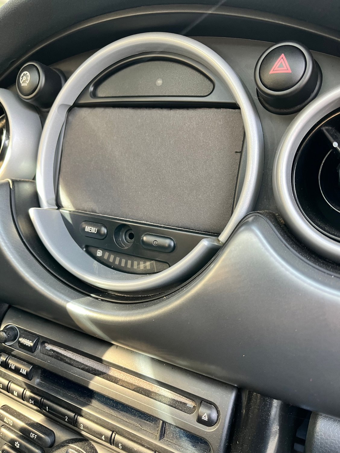

Nav panel is dead so removed it and I now have a nice 5 3/4” spot in the dash to add a temp gauge and volt gauge.

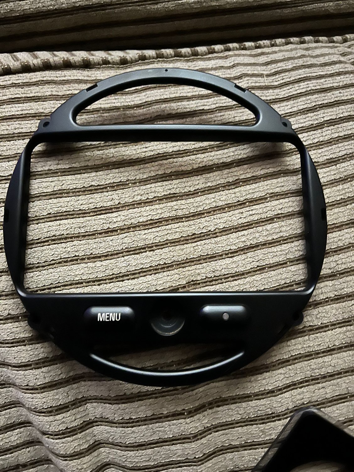

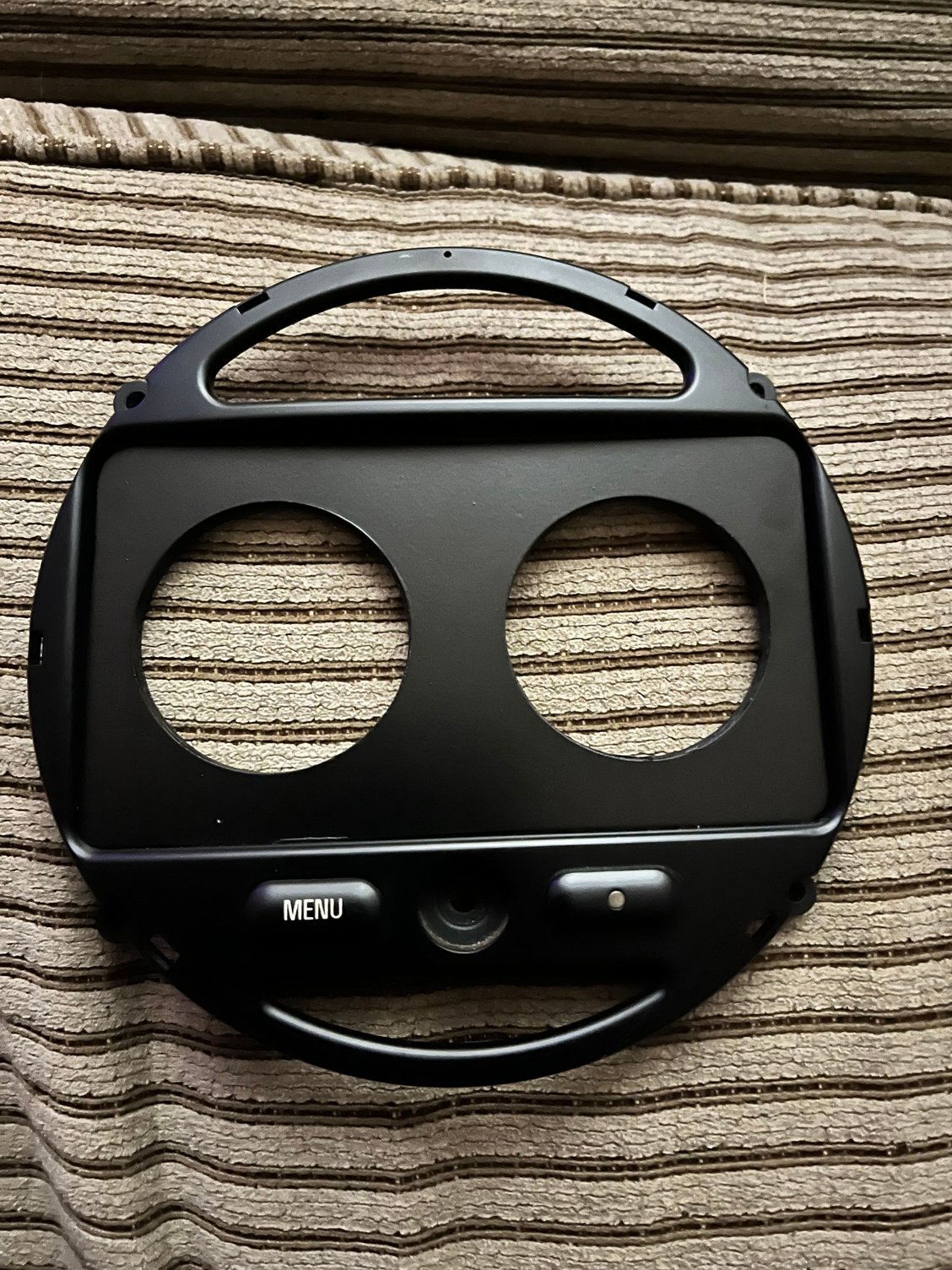

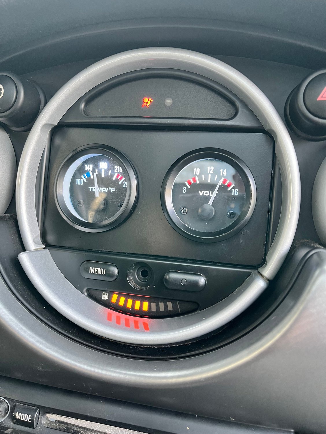

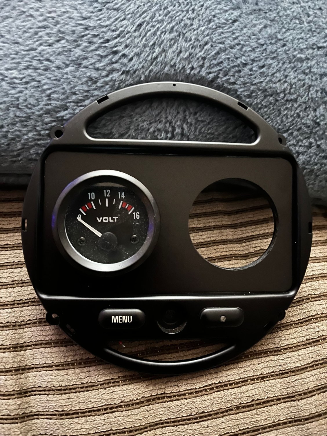

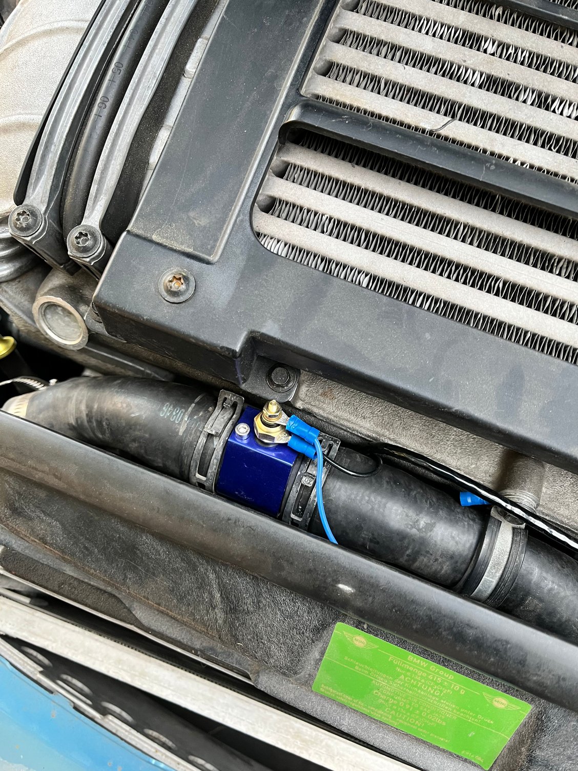

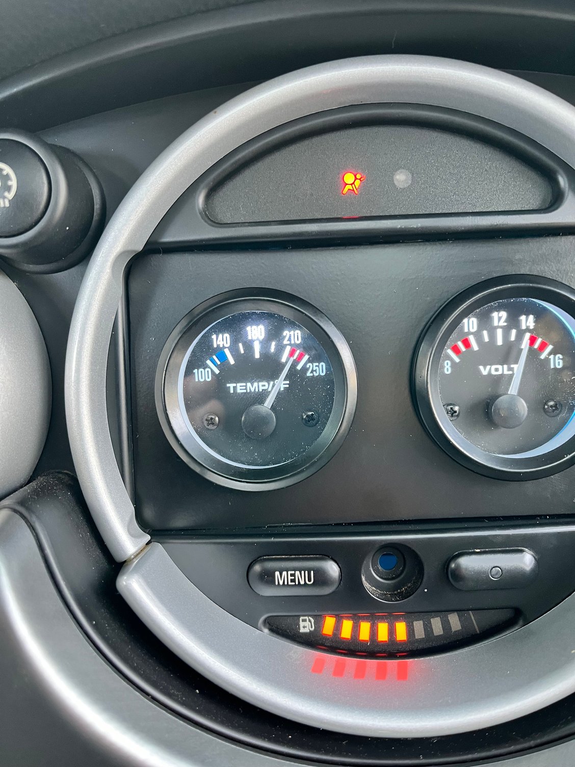

I ordered a temperature gauge w sensor and a voltage gauge on Amazon. Both 2” (52mm) and made my own custom gauge plate out of Lexan I had in the garage. Lots of cutting and grinding to make it all fit, but I’m pleased with the results. Was able to hack power off of the harness that went to the Nav screen. Ran the sensor wire through the firewall at the brake booster. Way more time than money invested. I spent $40 for gauges, $10 for the 32 MM coupler and $20 for 20g wire.
the only challenge was grounding the sensor since it is screwed into the aluminum coupler. I used a ring connector on the end of the wire and a small rubber seal (actually from on faucet valve seal I had). The sensor and coupler are pipe thread so the sensor didn’t snug down. The rubber spacer takes up the gap and pushes the ground wire connector up against the bottom of the sensor.

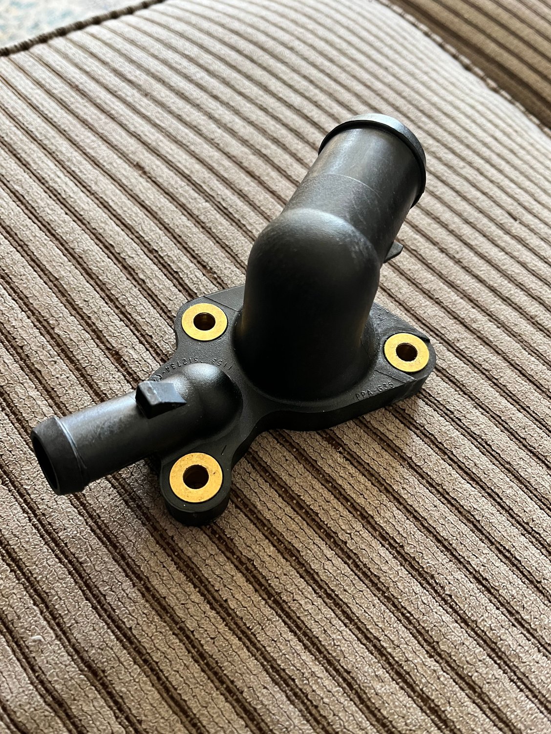

the only other thing I did was drill through the housing so I could use the little hole as an air bleed screw. (Little silver screw in pic) Easy peasy. I added teflon tape to make sure it doesn’t leak.
car warmed up and the gauge slowly climbed to 230* (ish). Then the fans kicked on and it dropped to a comfortable 210*
so, I consider it a win.
also love having a voltage gauge

Looks good! Coolant temp looks high? I might have gone for a 300°F full sweep temp gauge to get a little better resolution.
Old Dec 18, 2023 | 06:22 AM
TRagic's Avatar
TRagic
Joined: Aug 2022
Posts: 72
Likes: 29
Agree. The gauge is on the low end of precision. I will upgrade them in the future if I keep this car
