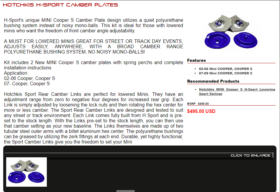

I believe Ireland Engineering when they say that they haven't had a failure since the redesign, seems to me like they corrected whatever problem there may have been and have since been pretty bulletproof. I like the design particularly because the urethane does help reduce NVH, as well as being a good budget option. I don't plan on becoming a track rat anytime soon (mucho money for that hobby!) and for the foreseeable future I'm gonna keep the Vogtland springs the previous owner installed along with Bilstein B6's --- coilovers may happen at some point but it'd be down the road a few years at least.
I love the idea of adjustable camber up front but at this time I simply cannot justify the nearly $500 asking price for the Vorshlags w/ stock perch (my want/need list is too big at the moment LOL and average cost is $300-$500+ for the stuff I want so I'm trying to be smart and frugal about it all because it really adds up fast!)
So,
very soon I'll be getting some of the IE adjustables.
Quick question -
I have some Cravenspeed strut tower defenders that I'm waiting to install when I get my susp. sorted very soon, doing a lot all at one time kinda thing, but I've read that the IE fixed plates use longer than stock bolts and must be cut down if the defenders are to be installed --- is the same true with the adjustable ones?
Or are the bolts shorter than the fixed ones?
And,
further rambling:
I noticed that Hotchkis used to sell adj. camber plates with this urethane design, but they were discontinued around 2016 or so I think?
Anybody know why they quit making them?
Did they suffer too many failures?
Just curious.
These are the ones I'm on about:

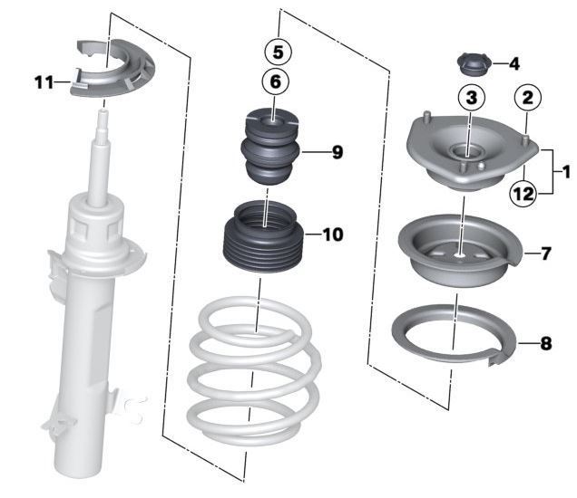

My car is set up pretty stiff, my wife hates it. But with the Ohlins set to about the midpoint of the adjustment range and the non-runflat tires, it works for me! I think it is better ride quality than it was stock.
My question about the top spring perch referred to #7 and 8 in this picture
(screen grab from realoem.com)
If you have that for your H&R springs then you just need the top mount #1 and the IE fixed camber plate just adds some offset.
Thank You i went ahead and ordered stage 2 IE adjustable ones. Hope this won’t happen again was tempted to get the race version for 10 bucks more but it’s going to be a rough ride for a daily
