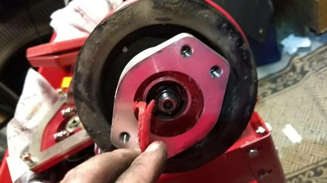

that's about all I got out of them. Watch out, I had 2 sets and both failed, the red polyurethane tears and once it starts to move they fail fast

when the poly starts to fail the center part will move more than the outer section, the friction makes them fail even faster. I put my car on the lift and the the whole thing separated and dropped right out of the camber plate top half, I was on the track the day before too, coulda killed me
I aligned them so I could get the most camber and caster

they only lasted me a few months, my street car had the same set and they failed too but I caught it before they became two parts.

Loctite wont help, the urethane failed
I put my car on the lift, this fell out, I had no idea it had failed the weight of the car was keeping it in place, good thing I was not aggressive on the curbing

got worried, looked at my street/autocross car (STX) and it was starting to fail too, these things were basically brand new
