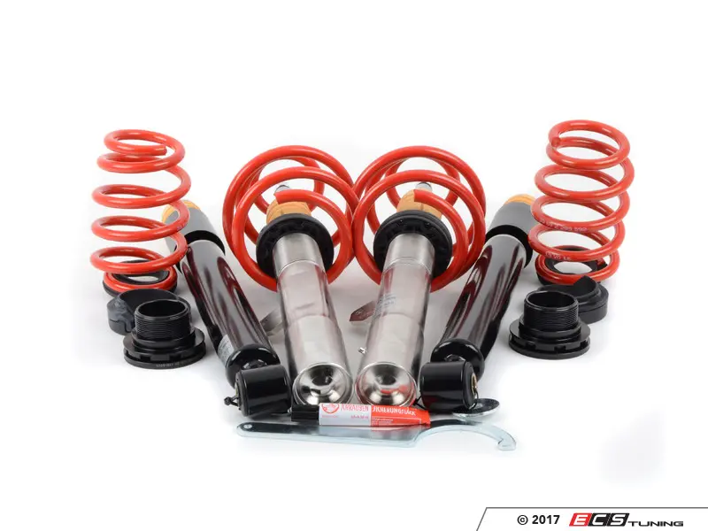

I came across this video on youtube. He stated that it has pro suspension added from the dealer. It's a JCW he explains. My question is this... if I just bought a 2019 JCW doesn't it have pro suspension?

No, that is an upgrade just like the JCW pro exhaust. This is a coil over set up.

Coil over setup? What does it do lower your car or something like that? Or what makes it better than the standard JCW?

It's height adjustable. It is a better set up than stock, but unless your serious I feel stock is good enough for most
Adjustable ride height. I put the JCW Pro kit on my F55 S. In warm weather I run about 2” lower than stock in the front and 1.5” rear; in the winter I go back to full height for better snow clearance. 😊

Is this a true height adjustable suspension ... or simply coilovers with preload adjustment??
Any pics or other info on these shocks?

Pre-Load and ride height not the same thing.
I thought it might be preload-only adjustable.... which will actually raise/lower the car...but will also change change the spring forces on the car which limits the ability to find the sweet spot at different ride heights.
For that kind of money... there are plenty of shock choices out there that have compression and rebound damping and independent ride-height-adjustment separate from spring pre-load.

Adj ride height
Originally Posted by bratling;4436474[left
When you realign the ride height, do you have to have the suspension aligned?
Adjustable ride height. I put the JCW Pro kit on my F55 S. In warm weather I run about 2” lower than stock in the front and 1.5” rear; in the winter I go back to full height for better snow clearance. 😊[/left]
When you change the ride height, do you have to have the suspension realigned?

If you change ride height, you will change camber...all other things equal.
Lowering the car will move you towards negative camber.
If you are a suspension guru... and know your stuff..or trust in an already "calibrated" setup... then you will know if that change is beneficial to you or not.
Your tires will wear more the further you get away from either extreme.
