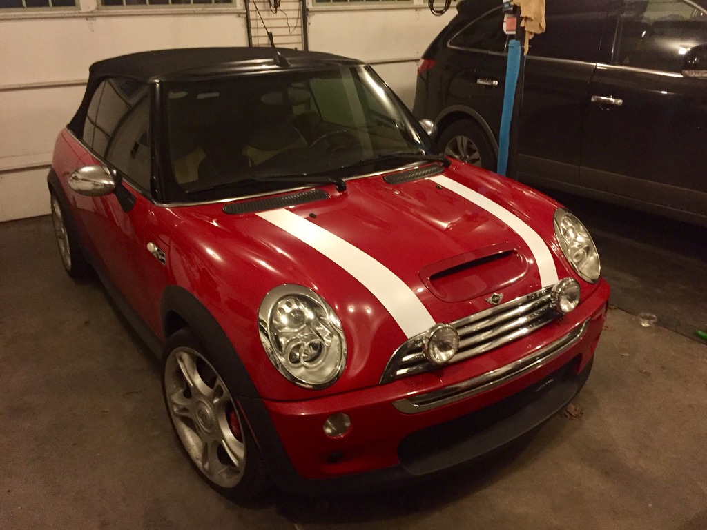

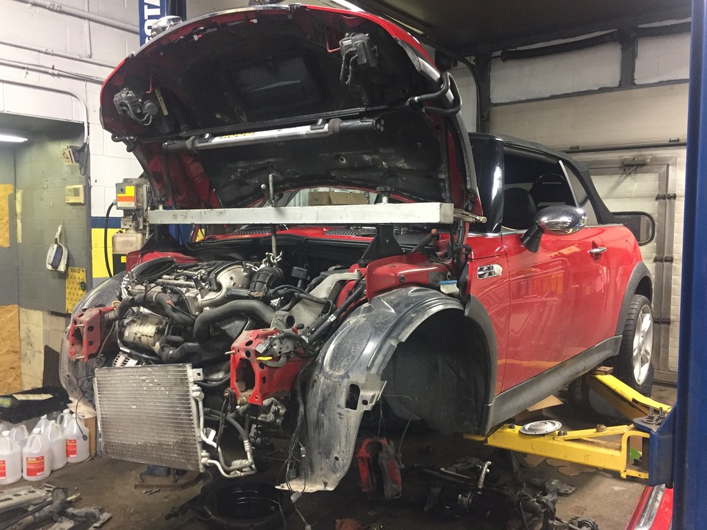

Finally got it back after 8 days in the shop! Replaced the clutch with a Valeo SM, supercharger service, power steering hose, Ireland fixed camber plates, Powerflex bushings, inner ball joints, rear seal, and crank o-ring. Final bill (I supplied all parts and fluids) was $1370.. Less than I expected.
Installed Mini Mania's magnetic bonnet stripes this evening to top off the mechanical work. I'll be biding my time driving 500 miles for the break in period.
First impression of the Valeo is a super light clutch pedal. I knew it would be lighter, but this is feather-light. Not a bad thing exactly, just will take getting used to. No chatter! Engagement feels good.
