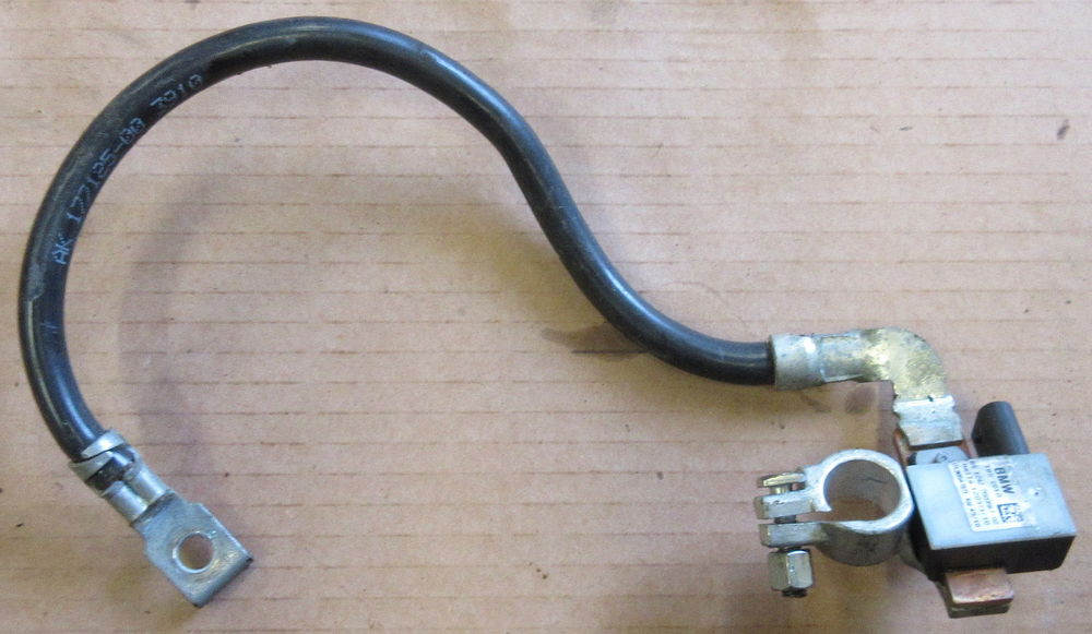

How can one know if the IBS system is in their particular mini cooper?
EDIT: Okay, I found this link - maybe others may also find it helpful...
http://www.pelicanparts.com/techarti...eplacement.htm

If your negative battery cable has a box on it, like in the photo, you will need to register the battery, when you change it. If it doesn't have that box, you can just put the new battery in and forget it.

DneprDave,
Thanks for the photo - that clears it up for sure!
Yes, note if you have navigation or a newer MNI, you will have the IBS system.
https://www.northamericanmotoring.co...nt-help-4.html
