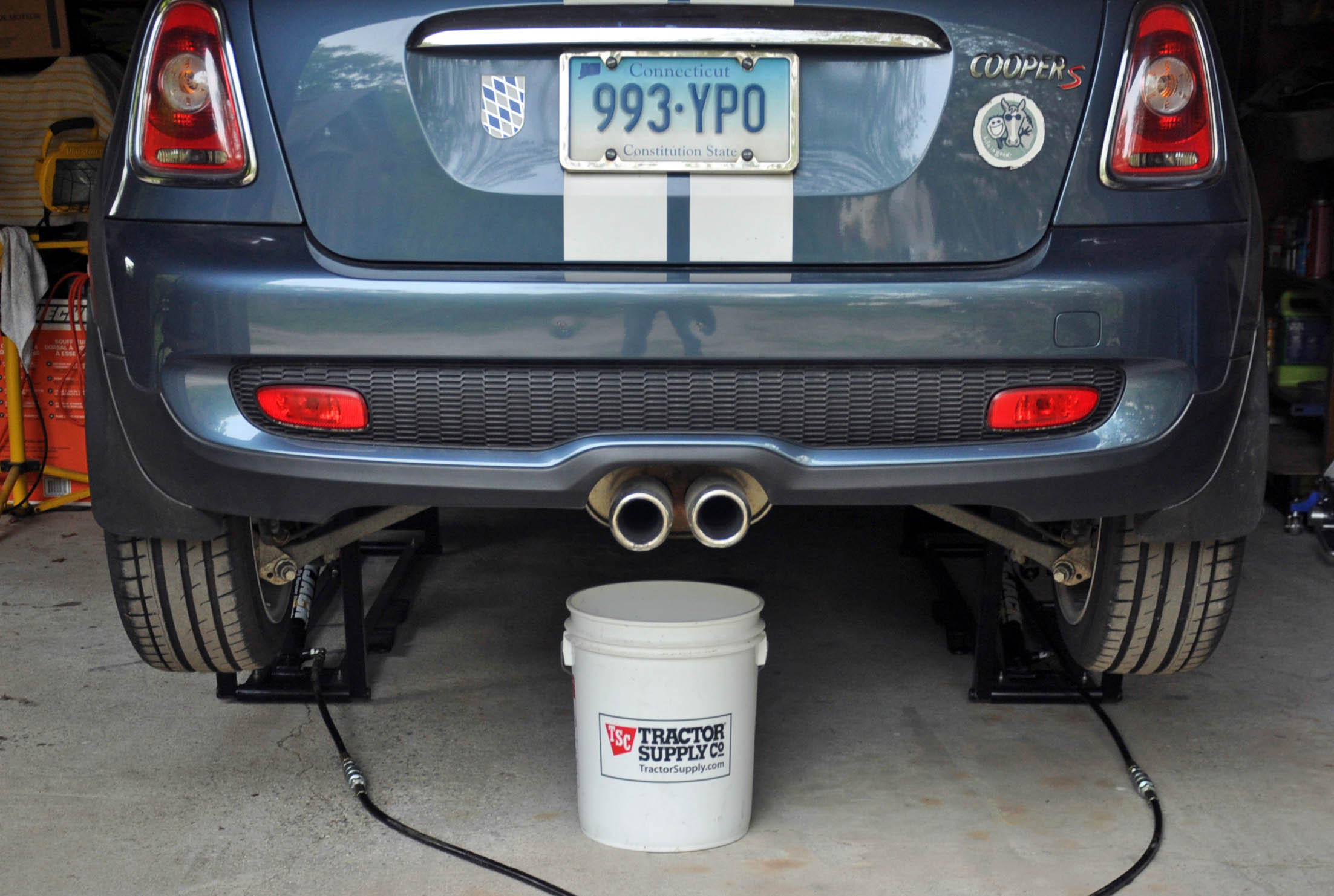

QuickJack 5000 Review-qj5.jpg, QuickJack 5000 Review-qj2.jpg,QuickJack 5000 Review-qj3.jpg.

The lift raises the car up about 22", max, and has a drop in locking bar. I used a 5 gallon bucket for a visual reference. I used my 2009S as a model for clarity. In the previously mentioned thread it is pictured under my 2013 JCW, so if you have a JCW, no worries, it works just fine.
QuickJack 5000 Review-qj4.jpg,QuickJack 5000 Review-qj8.jpg.

The jack comes supplied with some rubber protective lift blocks, but I found that the geometry of the car lift points, 48" center to center, and the dimensions of the lift, would require that one of the lift points would be right on top of a section of tubular steel that acted as a pivot. The supplied rubber blocks didn't seem to fit up correctly, and I just did not like the "feel" of the setup. You can see in the following pics that it is centered under the front lift block on the car chassis.
QuickJack 5000 Review-qj6.jpg, QuickJack 5000 Review-qj9.jpg.
It didn't matter which way the jack was oriented, it was going to center a lift block, right on that tubular section. I made my own set of blocks out of 3 layers of cabinet grade plywood and a top layer made of a solid rubber piece cut from a section of Stall Mat, ( 3/4" thick rubber mats used in stalls for horses and other livestock.) The total thickness of my home made blocks is ~3", so you can see that there is plenty of room to slide everything under a Mini.
The car is very stable on the jack and if a person were comfortable crawling under a car up on jack stands, there wouldn't be any issues for them crawling under this setup. I personally would put some dunnage under the jacks just in case, but I'm also a person that would place dunnage under the car up on jack stands too.
Well, that's about it for the review. It's actually a pretty simple, rugged ,lift system that offers an alternative to a bigger two, or four, post lift setup for use in a "normal" garage setting.
