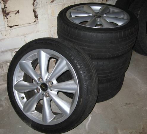

Not quite - those look like they are meant to have full center caps/covered lugs. These are the ones I am considering:

Those are R121 Conical spoke wheels 17x7" et48, 22 lbs
see
http://minicooper.wikia.com/wiki/OEM_Wheels_and_Tires
by comparison the S lytes are the heaviest MINI wheel at 25 lbs each.
