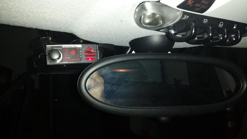

Dots are just for decoration.
AM antenna is indeed in the long wire sticking above the roof line (aka remote control antenna;-). FM antenna is in the rear windshield, coupled with the defrost wiring (as has been the case in all bimmers for the past 20+ years).
I place my V1 above and to the left of the rear view mirror, easily within arm's reach (so that I can press the control **** to mute it, as necessary).
You also want to give the rear antenna (in the V1) a clear view through the rear windshield to get maximum sensitivity. This placement works for that purpose as well.
Lastly, I hard wired the power so that it comes on with ignition (IIRC I tapped into map lights). This way you never forget to turn it on or off.
Pics below.
