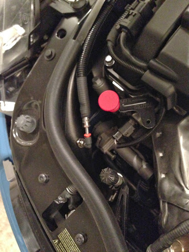

Ok, so the placement of the jet is pretty much exactly as I had planned. As for the boost port, it looks like you went with one of these:
http://altaperformance.com/i-1400715...bo-engine.html
instead of something like this:
http://new.minimania.com/part/G2NME4...-Mini-Cooper-S
Which if for nothing but the price difference, I was also leaning towards. Too bad they don't just have a vacuum line I could throw a T-valve on... but thanks for the pictures! Exactly what I was looking for!

I actually don't have a boost tap installed. The Alta or the NM Engineering ones seem to be popular.
http://www.nm-eng.com/nm498856-nm-en...ensor-tap.html
Aquamist taps into the ECU. All triggers are electronic. It's a combination of injector duty cycle and boost.

They way you are going to install it is great. It's how a lot of people have installed theirs.
Where to tap in for the +12V switched power, the Aquamist has us tapping into one of the ECU wires. The pump is powered directly from the battery via a relay.
Roxspin72 on here has installed a kit like yours, shoot him a PM, maybe he can tell you where he spliced into.
