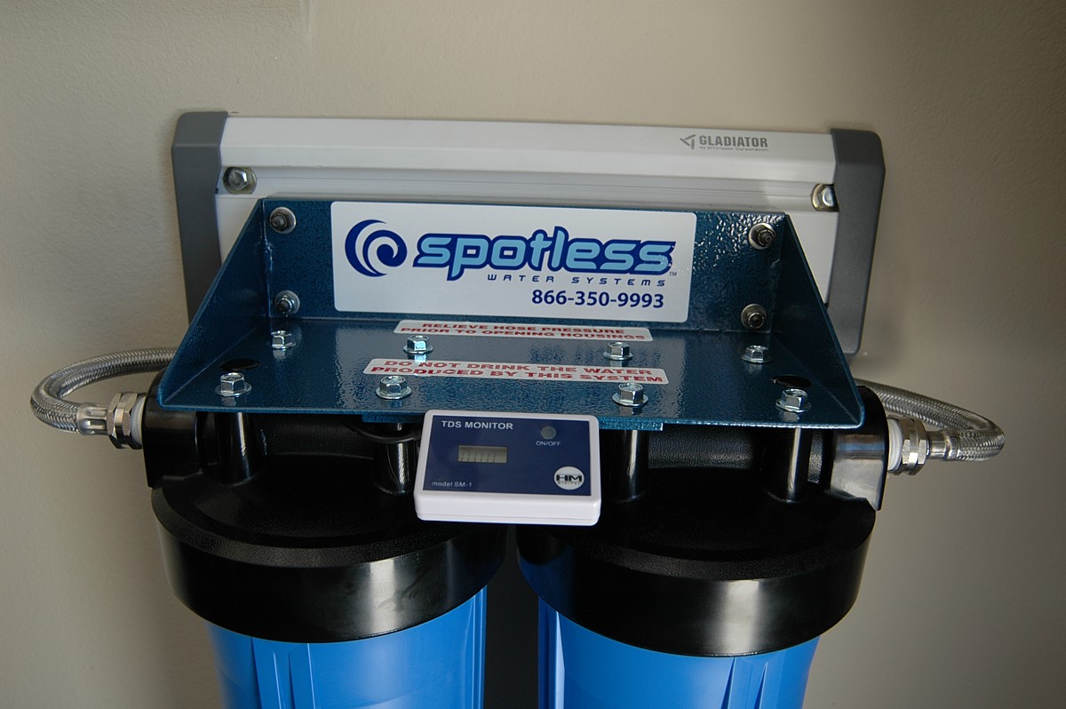

I had some Gladiator mounting material left over from the cabinets so I made a bracket for the filter assembly. I can lift it off the bracket very easily if I need to work on it.

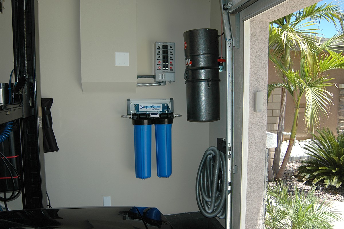

I also bought two extra filter sets to make it easier to switch in new media when it's time. You can buy the media seperately in bags for less and replace it in the inner canisters yourself. I thought two extra sets of canisters would make it more convenient to have a set ready to swap in.
The hoses go through the wall to the diverter valve box on the other side.

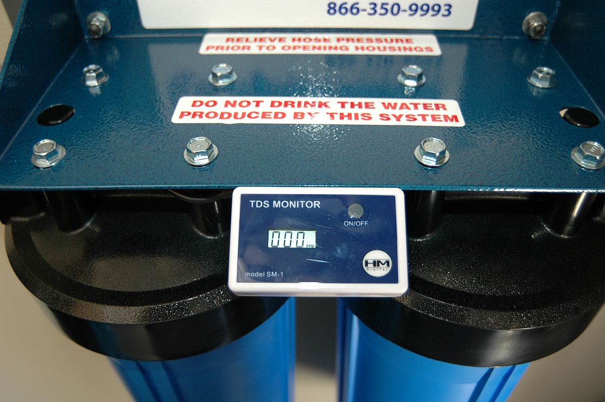

An electronic monitoring system lets you know when it's time to change the filters. Each filter charge gives you 300 gallons of deionized water - which is substantial since you only use the filtered water on the final rinse.

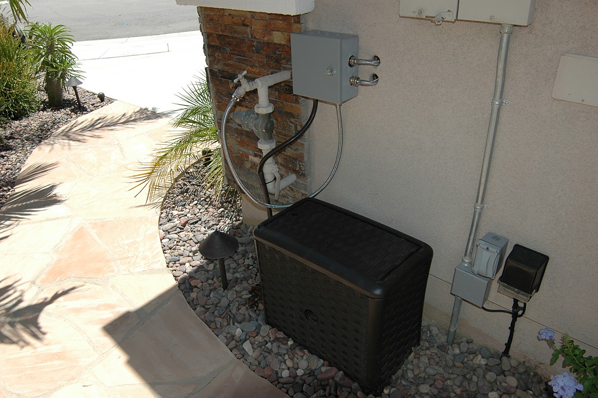

I modified an 8" x 8" x 4" electrical junction box to house the valve assembly and mounted it near the spigot. I included an anti-backflow valve inline with the unfiltered line to keep unfiltered water from flowing to the output side of the filters.
