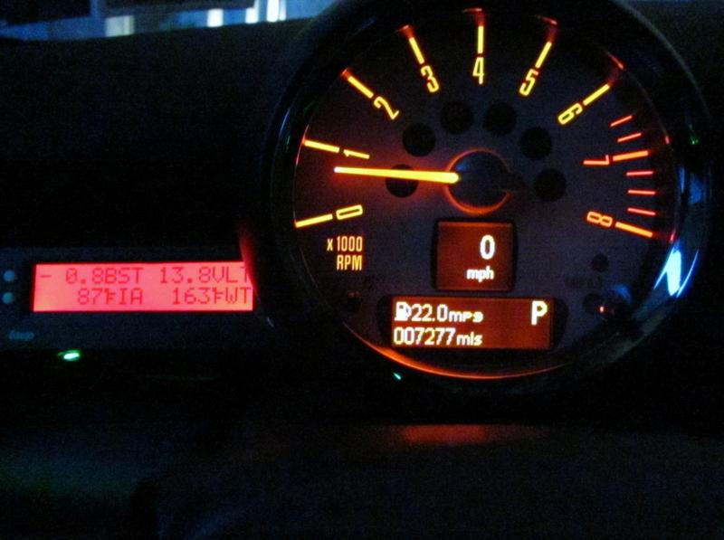

Also, here is the ScanGauge II installed:
Attached Thumbnails Boost gone after an oil change???-scan-gauge-installed-copy.jpg
