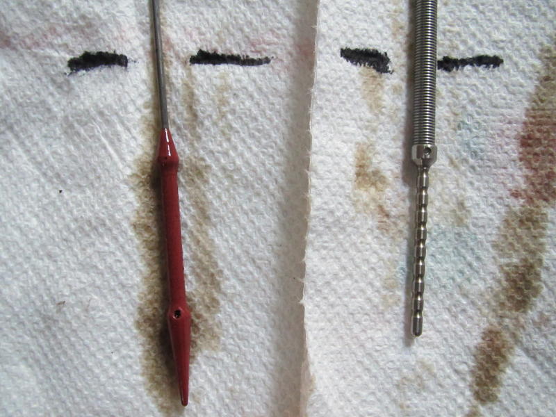

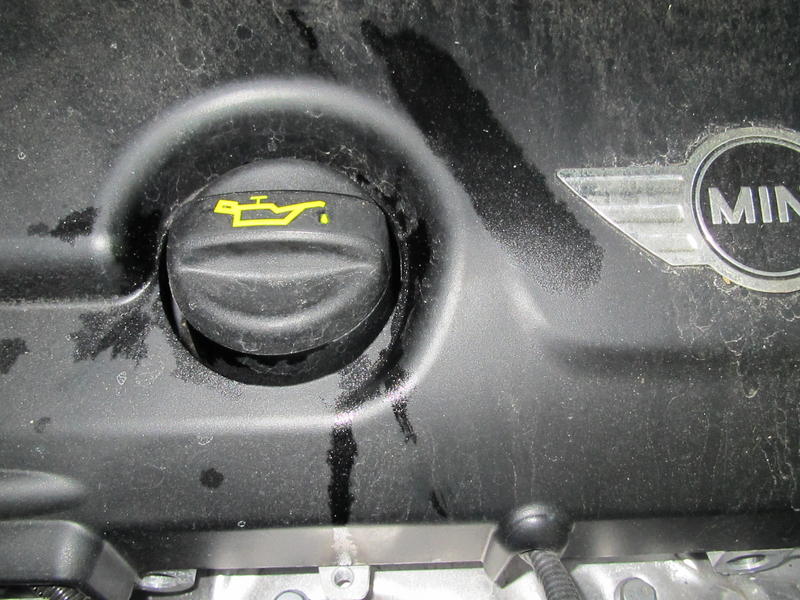

I am in need of some advice (Again.. my apologies):
Attached are pics of the OEM dipstick alongside the CraveSpeed one. It does appear that the oil was overfilled! No check engine light. No oil leaks from the bottom of the engine. However, there seems to be some oil coming out of the top of the engine from the oil cap (see photo).
How should I approach my service center about my concern?
Should I email/call my consultant exclusively or should I get supervisor/management involved?
I really just want this done correctly! (or the very least... the next oil change to be precise.)

Oh, wow, that is REALLY overfull. Its to the marker line correct? Call them ASAP and tell them about the loss of power. It is 100% due to being overfilled and crank windage. Just explain you checked it, and never added any.. but it looks very overfull. You want it taken care of.
To put windage in ever day terms, its like trying to run.. in a lake with your knees below the water line.. it slows you down.. the deeper the water.. the slower you go.
Same goes for the crank in the oil bath.. generally the crank is *above* the oil line..
Get that oil level drained ASAP.

When the crankshaft whips the oil into foam, you lose oil pressure. Then the oil pumps try to push to foam thru the oil passages which does not have a chance and neither does the engine.

Here I was hoping that my first oil change would go smoothly (even after reading so many "horror" stories of dealerships overfilling oil). Guess I was too optimistic.
I have emailed (attached pics) and will call my Service Consultant tomorrow AM. I hope he takes care of me and my MINI. So stressed... in the mean time is it ok to drive him? Maybe take it easy?
Thank you danjreed and Braminator! Appreciate the knowledge and advice!

Absolutely DO NOT DRIVE it unless you drain some oil. You can risk major damage if you drive it. You can blow out seals or you can vapor lock the engine. So don't take the risk.
Old May 20, 2013 | 06:40 PM
danjreed's Avatar
danjreed
Joined: Apr 2013
Posts: 1,894
From: Philly PA
Only thing is, if the owner drains the oil.. they have no claim the dealer ever did anything wrong.
I'd drive it real easy.. real easy back to the dealer..
Unless the engine is making noise.. chances are its ok.. ticking from lack of lubrication (air/foam/whipping) would show up as sticking in the head area under hard driving... (or just acceleration..).
If you didn't have this, you'll be ok most likely.
