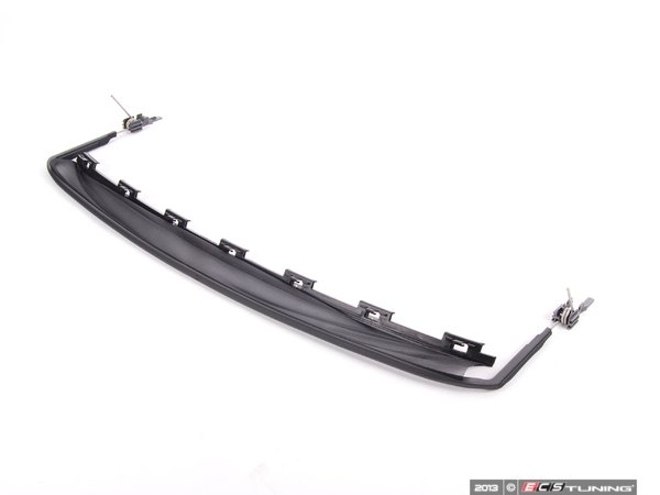

Here is the part and diagrams: R56 MINI Cooper
Front sunroof screen section: #5 Part number 54102757016
https://www.ecstuning.com/Search/Sit...h/54102757016/ Aftermarket is available
Rear sunroof screen section: #5 ( incase someone needs it ) Part number 54102755849
http://www.ecstuning.com/Search/SiteSearch/54102755849/

#4 is also the screen that tends to get holes in it right at the crease in the fabric over time. Bugs and debris fly back and hit it sometimes creating holes. Its easy to change out the Slipstream Deflector. Roll the front glass sunroof back. Clip out the rear section with the spring near the rails. They have little tabs and slide forward then work on the front tabs. Pry easy not to snap them and work your way from one side to the next. Comes out then install n reverse.
Slipstream Deflector Part number 54107355232
http://www.ecstuning.com/Search/SiteSearch/54107355232/
Thanks and glad you have things working again.
