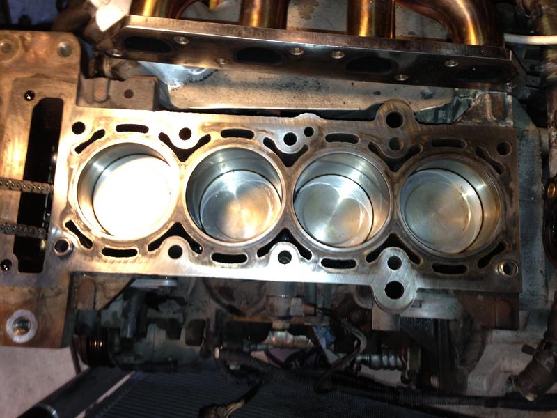

I use the M1 0W40 here in the 100+ summers of Vegas and have no issues what-so-ever.
Having said that, I do change my oil every 5-7k depending on how hard I've been running.
Just tore my engine apart last week. The head was spotless and the surfaces of the pistons took just 10min with starter fluid and a brush. (06 R53 128K)
