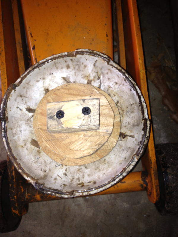

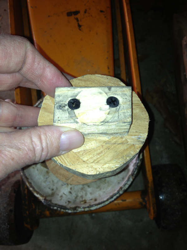

Here's mine. Also plywood- in two pieces since I have a little bigger jack than most and it won't fit under till the jack is in place and then I slide it in and up we go.

Rgoodwin - that kind of looks like what I ended up with. Taking white3's suggestion I bought a hockey puck for the round part and made a couple of wood inserts like OceanMini2 for the jack pads.
