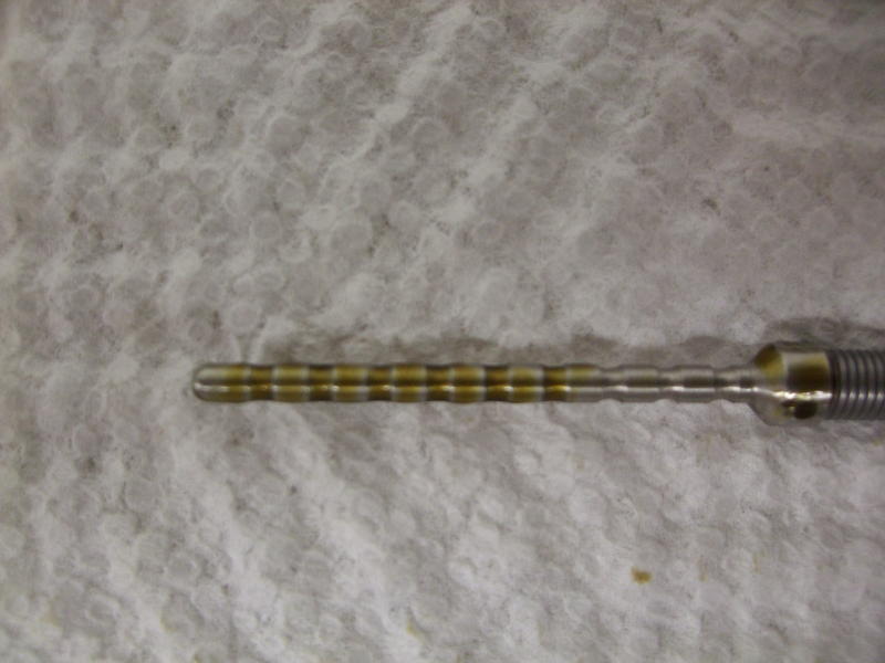

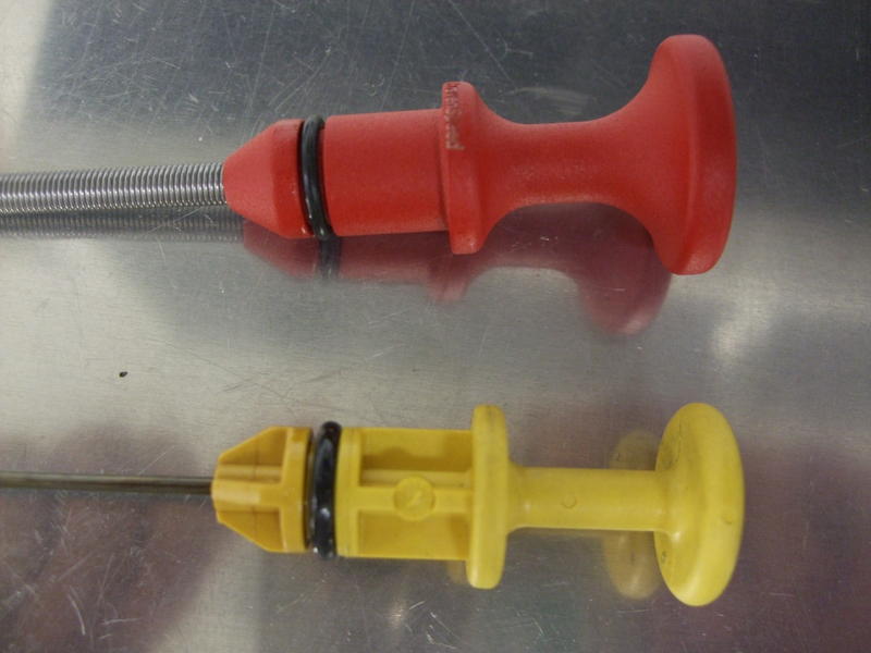

Craven oil dip stick
I purchased the Craven Speed oil dip stick and love it! As you know the factory Dip stick is very hard to read. The new dip stick is flexible and does not bind up against the filler tube which makes it so much easier to insert and remove. $79.00 bucks well spent!

I modified my dipstick as BlackIce showed on the following posts. I was expecting the change to make it easier to read the oil level. It surprised me how much it helped. Great job BlackIce.

I agree that the Aftermarket dipstick is easier to see oil on it over the standard non altered dipstick. What is interesting to me is that the aftermarket stick still has oil on the wide part at the top (the part where the spring starts). If the oil level was at 4.4 quarts the aftermarket stick would still look like more than 4.4 quarts of oil was in the crankcase. You still have to get the oil out of the tube to get an accurate reading when the oil level is correctly full.

I agree with OceanMini2 that for a 100% positive reading, the oil must be drained or wiped out of the dipstick hole. I have tried the multiple partial insert method to clean the dipstick tube and the cold oil reading method to drain the dipstick tube. Both of these methods are very consistent. With either of those methods the oil level is the same all around the dipstick with no oil on the dipstick above the level shown if the oil is not overfilled. BlackIces modified dipstick is much easier to read that the unmodified dipstick but I like the cold reading method the best. If you take the dipstick out and leave it out for at least two hours, the oil tube will completely drain. Also the oil as it cools will contract and the level shown will be below the level when the oil is at its full operating temperature. This drop in level puts the level further away from the upper bulge and makes it easier to read. You do need to take into account that the oil level is actually above the cold reading when at full operating temperature. See the following post for the change in oil level with temperature.

With BlackIce's modification (shown in the links below) I can read the oil level 5 minutes after shutting off the engine as MINI recommends. When I compare the readings taken after at least 8 hours, the difference is about .2 quarts as OceanMini2 stated. I like to take the reading when the engine is cold because the level is below the upper bulge and easy to read. With the full 4.4 quarts and the engine at full operating temperature, the level is on the upper bulge. Before I modified the dipstick, I would take the dipstick out, cover the dipstick tube opening with a piece of tin foil, wait at least 2 hours, and then take the reading. With the correct amount of oil, the cold reading was easy to see on the factory dipstick. With the modified dipstick, I leave the dipstick in and wait for at least 2 hours and then take the reading. You can leave the dipstick in with either the Craven dipstick or the modified dipstick since they don't pull the oil into the dipstick tube like the factory dipstick does. There will be oil wiped off the tube by the upper bulge of the modified dipstick or the spring end of the Craven dipstick but you can see the clear area above the oil level.

I agree with this. The aftermarket or modified dipstick that does not have the lower cone helps reduce the amount of oil transfer to the tube. The part below the splice to the spring or upper ball is more protected and seeing a gap helps you to understand the oil level better. Without seeing the gap you can't tell if the motor is overfilled. The tip still rubs on the curved wall of the tube however and picks up oil when the tube has oil on it. You still need to be careful hot checking when the oil level is below 1/2 quart.
