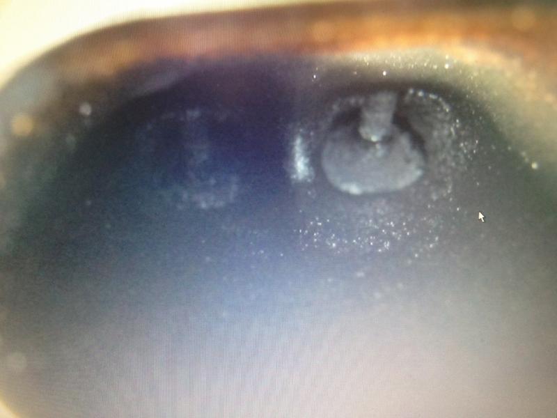

I paid $800 dollars to have my intake valves walnut blasted on the 23th of August, world of a difference! Mine was really bad, installing PCV delete and BSH catch can in the next couple of days.
Updated with pictures
