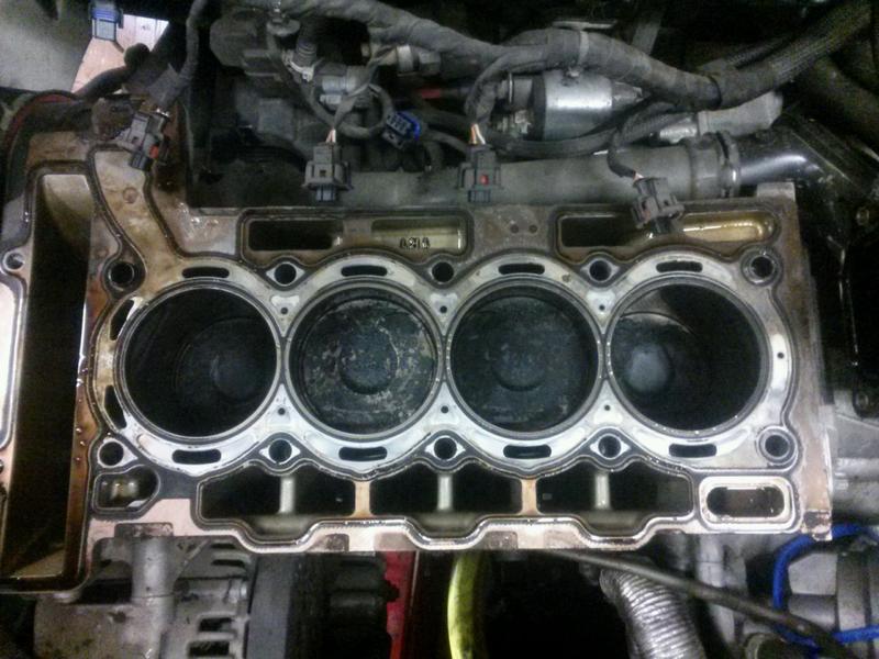

Diagnosed with carbon buildup and 2nd cylinder 25 psi
Originally Posted by pjdaustin
If you MIni has been diagnosed with a carbon buildup problem in the intake and required cleaning please post your mileage, model and resolution - dealer serviced at Cost, or no charge. Let's get a count going and number every post.
My Mini Cooper Super S 2007 was diagnosed with carbon buildup. Mileage is at 118,000+. Cost was $700 to clean but I didn't do it. The check engine light came on and stayed on, but I noticed NO CHANGE in performance of auto, until 6 mths later when another light came up indicating there was a loss in power, and in fact, there was. Drove it home going around 60 mph (down from 82mph). Put the car in the mechanic's shop today. Waiting for valve job completion. Will give me pictures of inside engine and I will post them here. Note: if you see a link here do not use it - it hangs, just go to my next post and click on each picture to maximize. A hole happened in one of the valves. Don't know how this happened.

Pictures of Carbon buildup and hole in valve?
Here are two pictures:Engine Carbon Buildup Problem census count-2013-12-19-15-46-19.jpg

This happened because the valves had so much carbon on them that at least one couldn't close completely. My thoughts are your $700 saved by not doing a needed carbon cleaning cost you a whole lot more for the valve job.
You are saying that the hole was caused by the valve not being able to close properly? Do please explain how a 'hole' could happen because it couldn't close properly? Yes, of course you are right. I have definitely learned a lesson! The valve job is costing $1,324 which is very low for this type of work. What I have bought with that also is the great knowledge picked up from this thread, and my personal experience. In short, if the light comes on, even if there are no symptoms, take care of it asap!
Did the pressure literally push a hole through the valve, or did it cook the valve and become brittle and break off? Sent from my iPhone using NAMotoring
If the valve couldn't close all the way, then it would be stressed by the uneven pressures from incomplete support behind it and combustion before it. Stress fractures would follow and eventually, as we see, the part started coming apart. Heck of a cautionary tale!
$1300 seems like a very fair price for the amount of work that goes into this repair, btw. Still, what a bummer. Hell of a holiday event. :-(
So, uneven pressures due to carbon buildup. Yes, indeed, a lovely cautionary tail for Christmas...still, it IS a gift because who can get that job done for so little?! I get the car back tomorrow. It will be a 3 day job. My nephew seems to think that I will continue to have issues because
"[FONT=Times New Roman][SIZE=3][FONT=Arial][SIZE=2] these heads and valves must be made of cheap material for a hole to have blown through a valve like that. Its as if there was some debris floating around in the engine. Although I suspect it is the cause of inferior head and valve material; in turn could be the cause of why excessive build up of Carbon seems to want to cling to valves and interior engine components; rather then burning up in the combustion chamber and eventually proceeding through exhaust. Glad its not costing you a whole lot to get it fixed. However I am of still the same mind set that there is something seriously up with the design and material of these engines, and wayyyyyyyyyy to many cases of people with reoccurring problems, and in that regard I still would be looking to sell the car and look at another Manufacture all together. "
Much has been said about the causes of the carbon buildup, but I don't think the above reason was part of it...
Well, I will be KEEPING my Mini - love it too much!

You don't have to look far to find more carbon deposits, intake runners and the back of your valves. Why, because of the direct injection there is not injecter to spray cleaning solvents onto the back of the valve, it's here where the carbon builds up on the back of the valve stem and can prevent it from closing all the way.
It has nothing to do with inferior metals, when you have high pressures from boosted engine any valve not closed all the way will have damage after some amount of time. My combustion chambers aren't that bad because I'm taking special attention to them keeping them clean and having my intake runners and valves walnut blasted every 20-30k.
A couple of cans of BG 44K will keep those combustion chambers clean.
