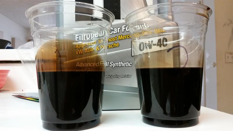

I you think this is bad wait till you hear what I experienced yesterday cleaning carbon internally. Yesterday I drove on the freeway to reach full operating temperature, then drove home and added BG's EPR or Engine Performance Restoration to my oil. I started up my engine and revved it for 12 minutes at 1500 rpms in neutral, shut off engine and drained oil.
Blackest **** I ever seen, not even light could escape. My brother and forum members said this next step was overkill, this was far from overkill. I bought two 5 quarts jugs of Mobil 1 0W-40 (Walmart) and added 4.5 quarts and revved engine for several minutes, shut her down and drained oil for a second time. Holy ****, it was a very dark caramel color (almost black) with lots of streaks of black swirls in the oil as I poured it into an empty 5 quart jug.
After draining that **** I replaced the filter with a new one and added 4.5 quarts of a second jug of Mobil 1 0W-40, it took me quite awhile to be able to see the super clean fresh oil. At the end of the day I found out it was well worth it to flush that dark dirty oil with black swirls out of my engine a second time sacrificing a perfectly fresh 5 quart jug of oil. I only have 54,000 miles, the amount of **** that came out of the second drain was amazingly filthy!
I can only imagine what other MCS's look like after 100,000 miles!

I like the idea of the BK-44K in the oil method.
Seems you have to keep after it on a regular basis something I had not done.
This snake oil really does work (), it's the second product from BG that I can say really does what it says it does. I have attached pictures to show the oil in each cup and notice how filthy both are, the second cup (on right) are the results after pouring in the clean new oil after I initially drain the original oil+BG's EPR or Engine Performance Restoration.
I tipped both cups on the side for a moment so you can see through the oil because it's hard to see which is worse without some serious lighting power. It pours out of the 11 fl.oz. stainless steel can clear with no color whatsoever, I might as well state that you don't want to drive your car anywhere with BG's EPR in your crankcase! What I would like to do is grab a sample from the bottom of the oil jug.
I wish I had somebody to film while I was pouring the oil into their containers, it was there that I saw the black swirl marks in the dirty oil. You don't know black until you see these black swirls, who knows where that black crud came from, piston rings, turbo oil feed line and all the oil passageways. It reminded me of watching gold separating from the sand when it's in the machines that separates gold from the soil.
Attached Thumbnails Engine Carbon Buildup Problem census count-20140927_172739-1-.jpg
