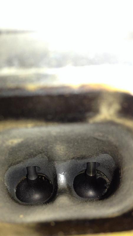

Just had the Walnut shell cleaning done at Motoring Magic at 60k miles. I've had an OCC installed since 30k and have been running methanol injection since about 40k. I'm sure the OCC and methanol help to reduce the rate of buildup but there was still enough buildup to impact performance.
The engine feels smoother and much stronger after the cleaning. The idle is smoother as well. I'm spinning the tires well into 2nd gear. Poor tires
The pic below is after the cleaning. It's well worth the $400 in my opinion.

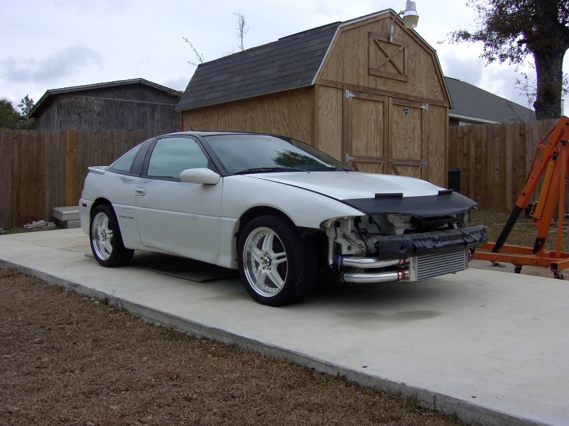

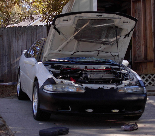

Some of you may not agree with this but I come from the DSM world and it is common to just plug up the port on the turbo inlet altogether and run a straight up piece of rubber hose from the drivers side of the valve cover directly to the ground, lol. All vapors and blow-by hit the asphalt. I ran my TSi like this for 15 years with ZERO crud in my fmic and my intake and valves stayed clean to boot (of course not D.I.) but without a OCC at all.
Attached Thumbnails Engine Carbon Buildup Problem census count-pdr_4465.jpg   Engine Carbon Buildup Problem census count-23796habitat.jpg
Glad you brought this up. I was discussing this with a couple of friends yesterday and we think this would work with the mini's. But I am by no means a mechanic. I know enough to get me in trouble .
While not environmentally friendly that is the way my 68 Barracuda has always been. It has little breather filters that look like mushrooms stuffed with fiberglass that are installed in the valve covers. They have to be replaced relatively frequently because they build up oil and it starts to drip. The added problem caused by inadequate crank case vacuum is that the blow by gasses and moisture build up in the engine. Did you ever check the oil on an older car and see that grey sluggy stuff? On the Barracuda the driving to oil changes ratio is low enough that it isn't an issue.
Possibly combining the catch can with a filter similar to the breather filters might help. The catch can probably doesn't do much for the vapors but under hard driving or hilly conditions it should catch oil that "splashes" into the system.
If you want to feel a little better go on over the the M5 board and see what the dealers are charging them to do carbon clean ups
