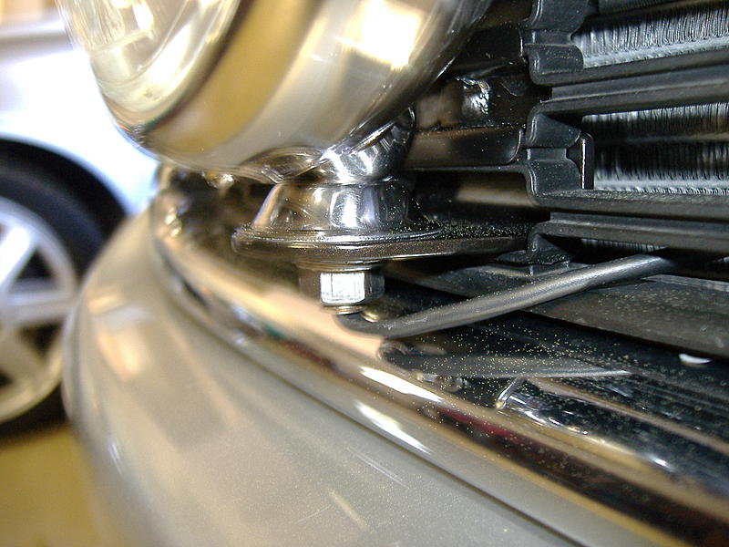

I believe the oem lights are closer to 5 1/2" (not 4"). I tried Hella 500s on my car for awhile but decided they were too large for my tastes (6 1/2" dia). I just switched to 5" Wipac polished stainless steel lights from England. They're available from RDX International Only on eBay UK for about $90 delivered without a wiring harness (I used my existing Hella wiring). A wiring harness is available separately. If you're at all handy, you can make your own brackets. I made mine out of 1/8" steel angle iron and mounted them to the backside of my JCW grill using 2 bolts thru the grill.

My measurement of the lights was the lens, I assume yours was the whole unit.

You're right: I'm referring to the overall diameter. The lens on the Wipac is 4" whereas the overall diameter is 5".
