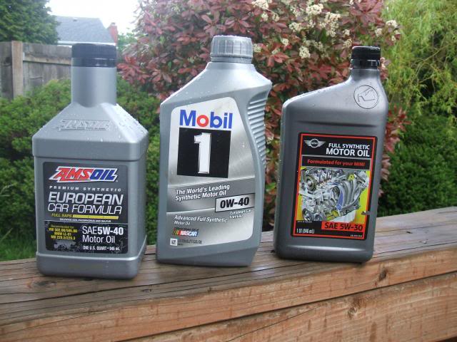

Oils I have used
Let's meet some of my friends:
I posted this to help everybody identify what is and what is not a long-life oil. Remember, not all synthetics are. If you are changing your oil at shorter than the recommended intervals, this may not matter.
On the left we have Amsoil European Car Formula 5W-30. Right on the front it says it meets the BMW spec. It's going in the wife's R50 in a day or so. The price was nice and the Amsoil dealer is right up the street from me. She doesn't drive much (works from home) so I change her oil yearly. She's got about 6k since the last change.
In the middle we have Mobil 1 European Car Formula, also meeting the BMW spec. I've changed oil with this, too, but it's somewhat expensive compared to the other two. I got this out of the back of one of the cars because it's available everywhere and we probably had to add some on a trip.
On the right is the MINI branded oil, available at the dealer, and also meeting the BMW spec although I'm not entirely sure it says it on the bottle. This is what I have been running in my R50 for a couple of years. I go the 15k/countdown between changes. I'll be doing Blackstone reports on both engines when I change the oil next to see how they are doing with the extended changes.
Val

Originally Posted by valvashon
... On the left we have Amsoil European Car Formula 5W-30. Right on the front it says it meets the BMW spec...
On the right is the MINI branded oil, available at the dealer, and also meeting the BMW spec although I'm not entirely sure it says it on the bottle. ...
valvashon - Thanks for the photos. I can almost read the labels, but not quite. When you say the Amsoil says it meets the BMW spec, does it specifically say "LL-01" or "Longlife-01"? (There is another BMW spec, LL-04 - which is not for the MINI.)
As for the MINI branded oil, the last bottle I bought did NOT have the LL-01 spec listed on the label - which just astounds me. Look down near the bottom of this page, and click on the image of the back of the MINI oil bottle to make it big enough to read:
http://garywright.smugmug.com/MotorC...5973451_bTQbF5
I'm pretty sure BMW part number 07510017866 is the same stuff as what's in the MINI bottle (MINI number 07510143829). A MINI service tech told me that both MINI and BMW use the same part number for the 55 gallon drums they supply to dealers.
Amsoil is LL-01 and API SN/SM rated.
http://www.amsoil.com/shop/by-produc...?code=EFMQT-EA
elscotty - Yes, your link shows the Amsoil 5w-40 is recommended for vehicles requiring LL-01.
Valvashon's photo shows 5w-40, but his text refers to 5w-30. The 5w-30 is recommended for vehicles requiring LL-04 (and not LL-01) http://www.amsoil.com/lit/databulletins/g2808.pdf
Two points:
1. Don't assume LL-04 is an improvement which replaces LL-01. I found several references to BMW literature which specifically states LL-04 is NOT for gasoline engines outside of Europe.
I don't pretend to completely understand the differences, but LL-04 seems to formulated to reduce emissions in diesel engines. Apparently the anti-corrosion agent in the LL-04 has a short life when exposed to the ethanol in most US gasoline. This might not be a big issue if you follow short drain intervals and/or can avoid ethanol, but it's easier for me to just follow MINI's recommendations and stick with the factory oil -- one less thing to worry about.
2. I'm not sure what to make of the word "recommended" - recommended by who? Amsoil is not claiming their product has been "approved" (by BMW) or that the oil meets the BMW specification, only that they recommend it.
Mobil uses stronger language, with this chart showing the Mobil 1 0w-40 (and only the 0w-40) as having "BMW Approval" for Longlife-01
http://www.mobiloil.com/USA-English/...duct_Guide.pdf
I couldn't find a spec sheet for Castrol's 0w-30 European formula (German), but the back of the bottle says "exceeds the ... standard ... BMW Longlife-01" Even so, if I use the oil finder on Castrol's US website to search for a recommended product for the MINI, there are none. I confirmed this on the phone with Castrol -- they told me they have *nothing* in their US product line which they can recommend for the MINI.
Last edited by runswithsizzers; May 22, 2013 at 07:04 AM. Reason: corrected Mobil 1 from 10w-40 to 0w-40
