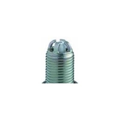

Originally Posted by ViperGTS
Ok,
I picked up the NGK: BKR7EQUP for my car.
I noticed they aren't 4 prong like the other ones.....
Is this an issue? Will it cause any problems down the road?
Thanks!
But they are 4 pronged

Bkr7equp
http://www.amazon.com/NGK-BKR7EQUP-M.../dp/B001B6VUQK

Yes, NGK BKR series have four prongs. So, you get that from the factory. 1st-gen MCS come with BKR5s or BKR6s, depending on the destination climate. Not sure about 2nd-gen MCS, but I would bet money it's the same.
