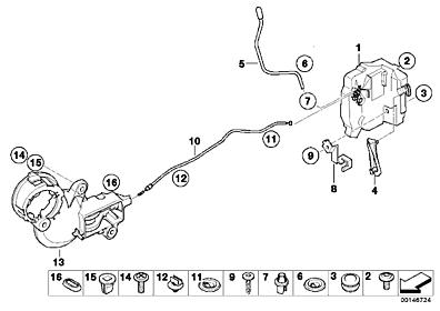

Door won't open
Since your door will open from the inside, then your cable is intact.
Looks like you'll need to replace part number 1 which is the door lock actuator.
Happened to me and there are threads here to help DIY.
Search the site.
Start at the DIYs and the HOW TOs.
I did mine in about 2 hours and did not have to remove the glass or the window actuator motor.
Hope it helps.
