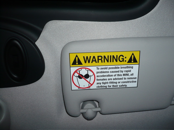

there are some witty ones out there. I bought this one, even though I haven't procured my Mini yet. It was custom made by a NAMer, so I had to get one.
https://www.northamericanmotoring.co...1&d=1213849536
Old Jun 29, 2008 | 08:27 PM
ngweibing's Avatar
ngweibing
iTrader: (11)
Posts: 4,070
canu tell me who made it?
