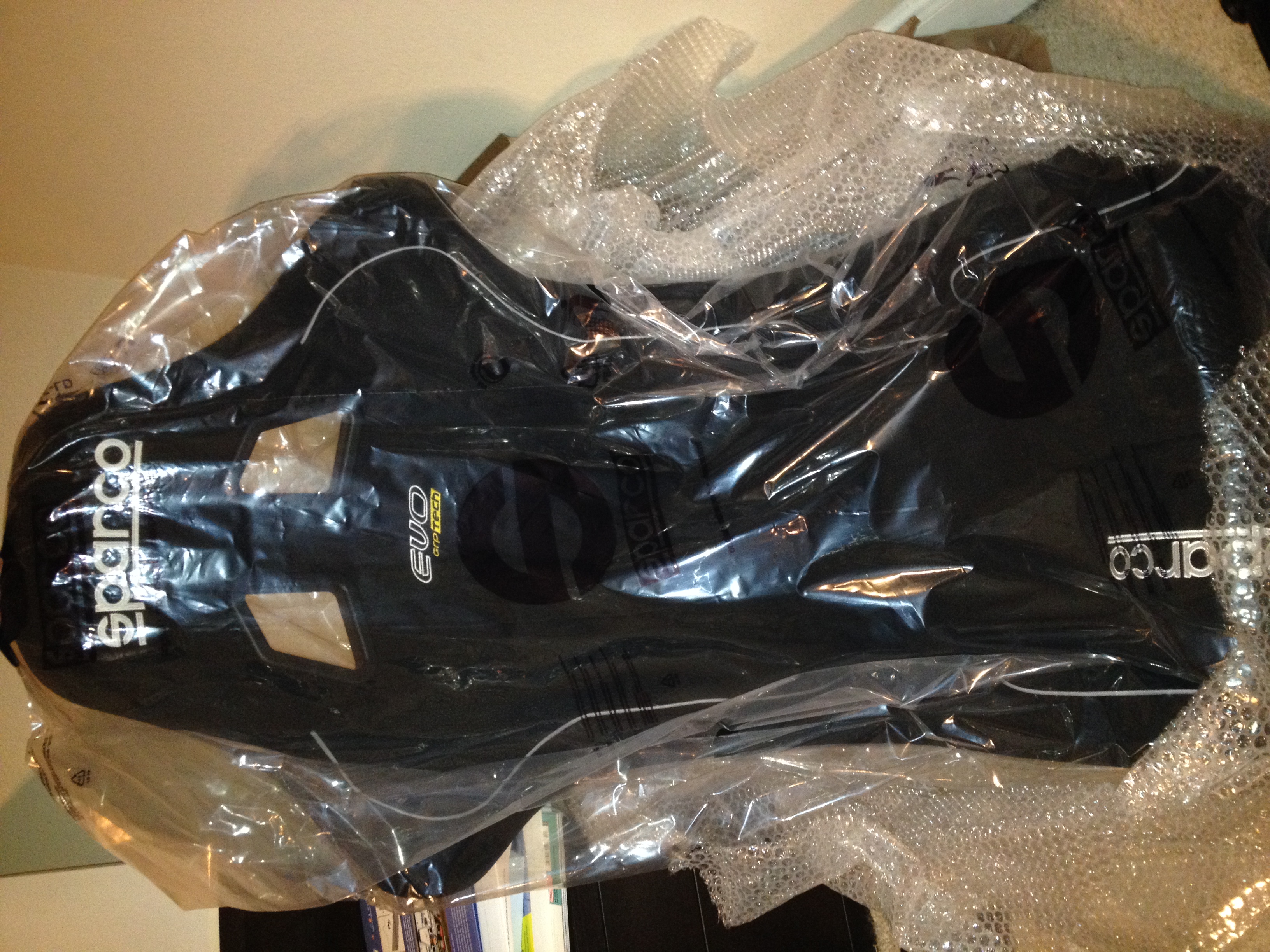

HI all - Just a quick update. I have a pile of parts and no time to install. This weekend I worked on my rear brakes which are riding a bit. I am scared the piston is not retracting properly (see pic) and couldn't really track down the problem. Basically spent most of Sunday on that. Brakes are still squeaking in the rear when brakes are not engaged.
Next track day is Feb 28. Will be getting the car in shape for another day at GSS which is a tire-eater of a track. This will involve remounting tires, oil change, brake fluid bleed, installing race seat. I got some hi-temp brake fluid from wilwood so will be running that.
Finally got my awesome oil cooler from madness which I ordered well before xmas. No installation instructions so I am a little nervous about install. I am not even sure where exactly I will place it. That probably won't go in until after the track day.
Also ... what do you guys think about yellow GT headlight tints ????
Attached Thumbnails Rennfahrer's Barely street legal track toy build-img_1278-1-.jpg   Rennfahrer's Barely street legal track toy build-img_1277-1-.jpg   Rennfahrer's Barely street legal track toy build-img_1276-1-.jpg   Rennfahrer's Barely street legal track toy build-img_1271-1-.jpg

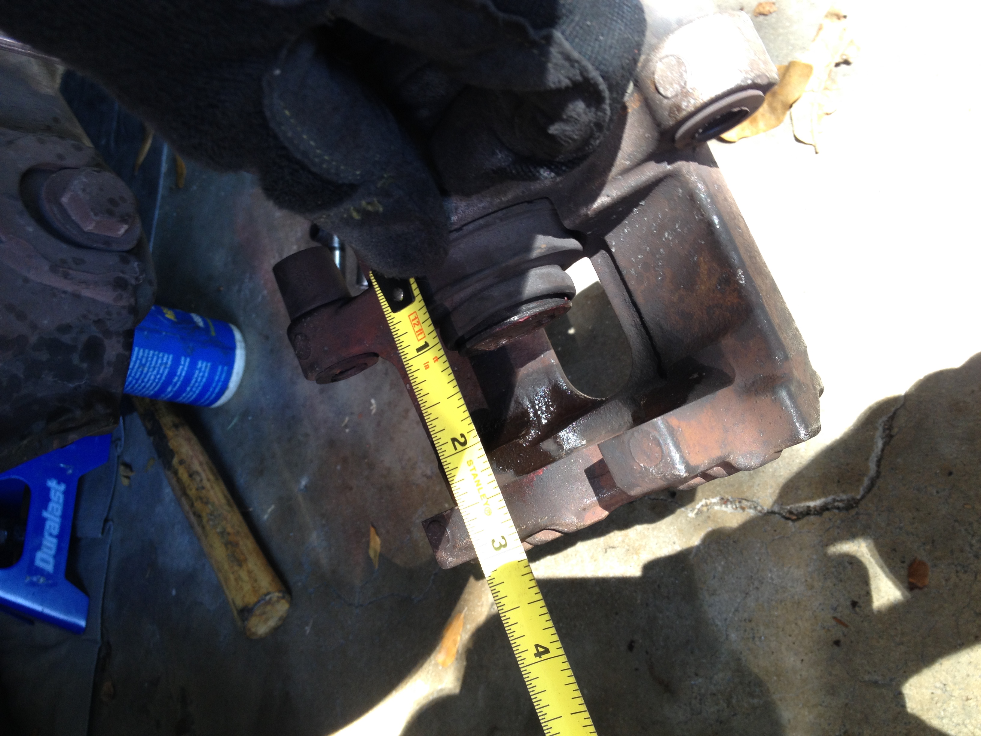

For the rear brakes. You just installed new pads/rotors right? Check out this thread HERE and see if it relates or is similar in your case.
While you're in there and doing this all maybe replacing the dust boot on them might not be a bad idea. I really need to do a complete reseal kit on my calipers as they have 180k on them and lots of abuse on the track. We have the rear caliper dust seal HERE.

Does the R53 use the anti rattle springs pictured in your article ?

Figure 17

Yes, #4 below is the retaining spring. Figure 17 in that article is in reference to I believe the front pads (last picture below). You'll want to look at figure 10 in the article (2nd to last image below).

Ahh that makes sense bc I didnt have those on mine. I def have the #4 retaining spring there. Its the part in the second pic that I do not think I attached properly at all.
FML

Ooooo, the R56 brakes are so much easier....

Done the r56 brakes and the R52 brakes many times. The spring clip in the back can be a pain to line up on the rear piston. I would start one side and then slide in the other, the clips like to pop out of place and can be a real bugger.
https://www.northamericanmotoring.co...ing-right.html
The r56 rear have those clips which snap in on the top and bottom. Most aftermarket pads don't have them so you have to reuse the old ones,. I clean them off with a wire push and dab on some high temp brake paste.
