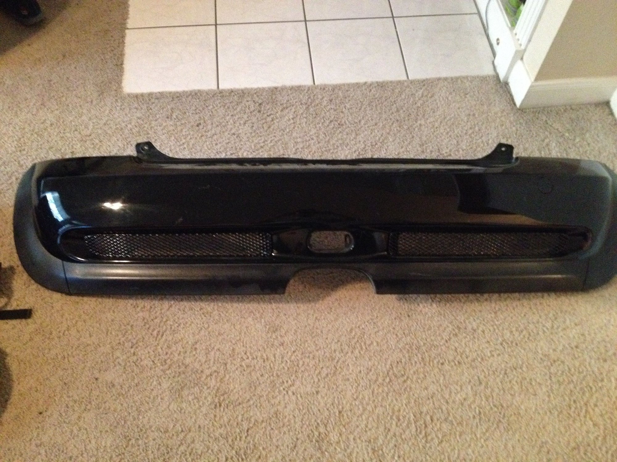

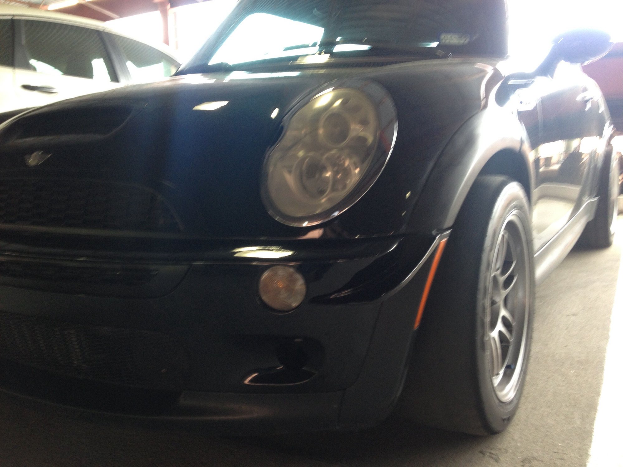

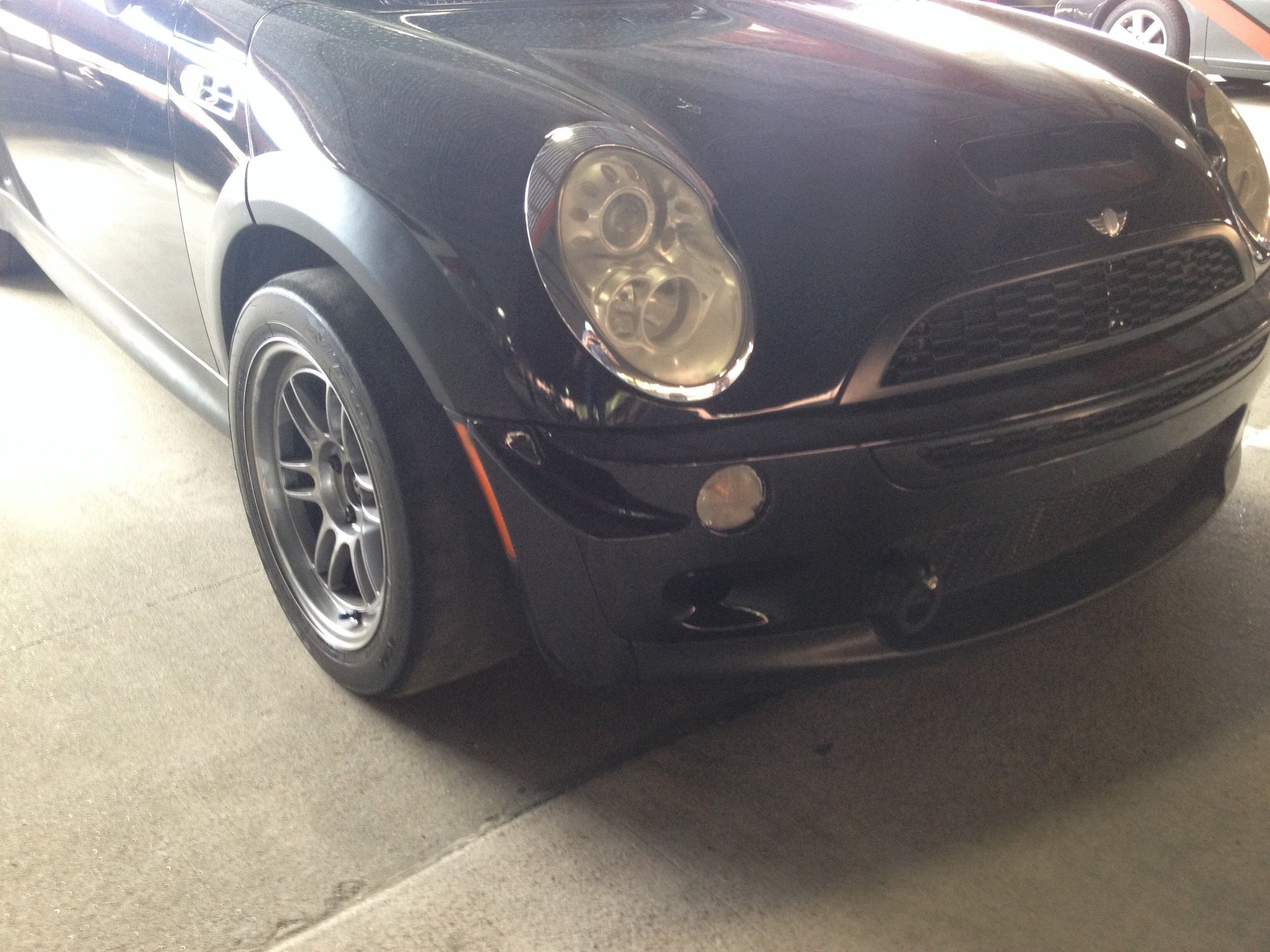

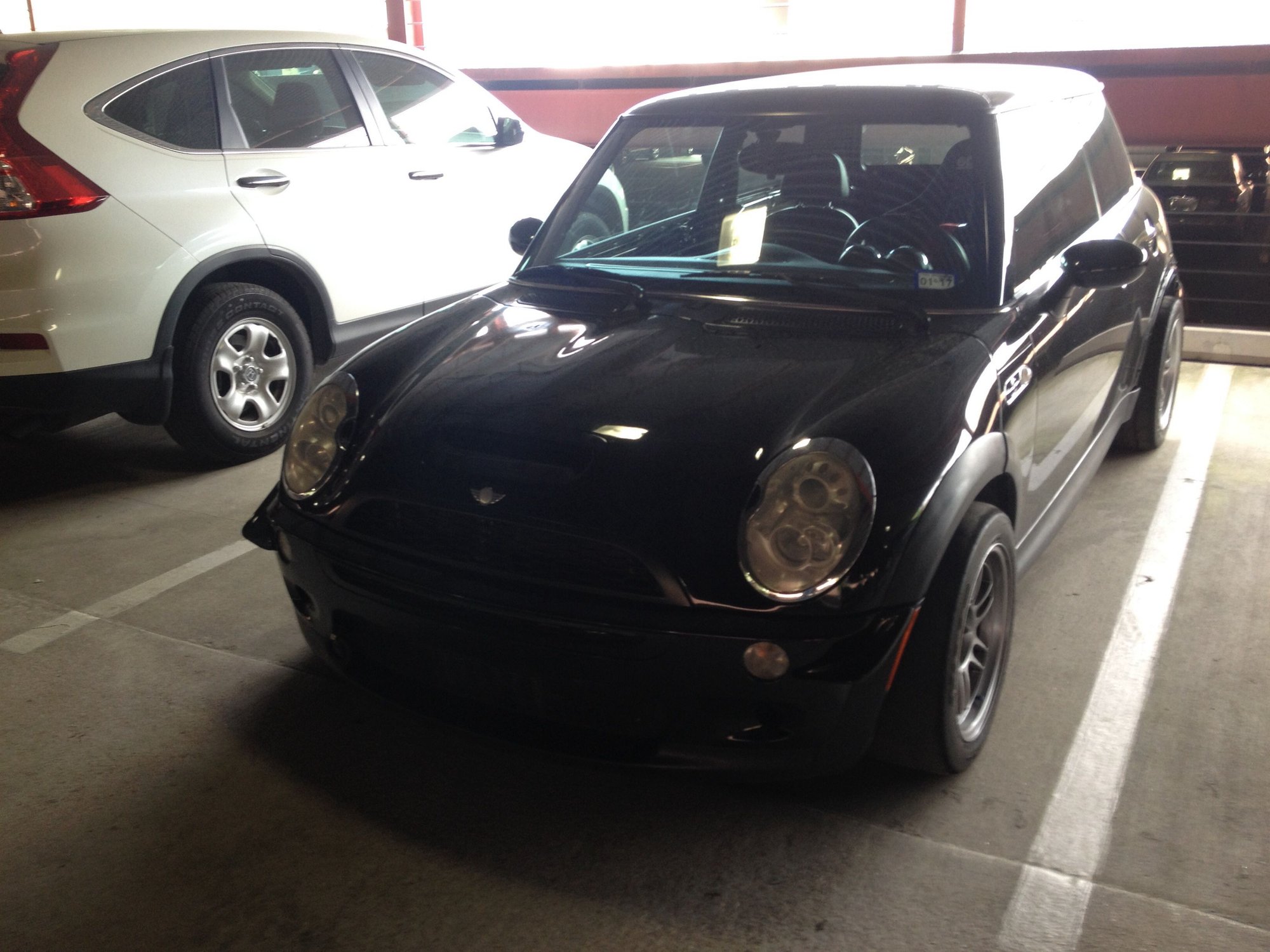

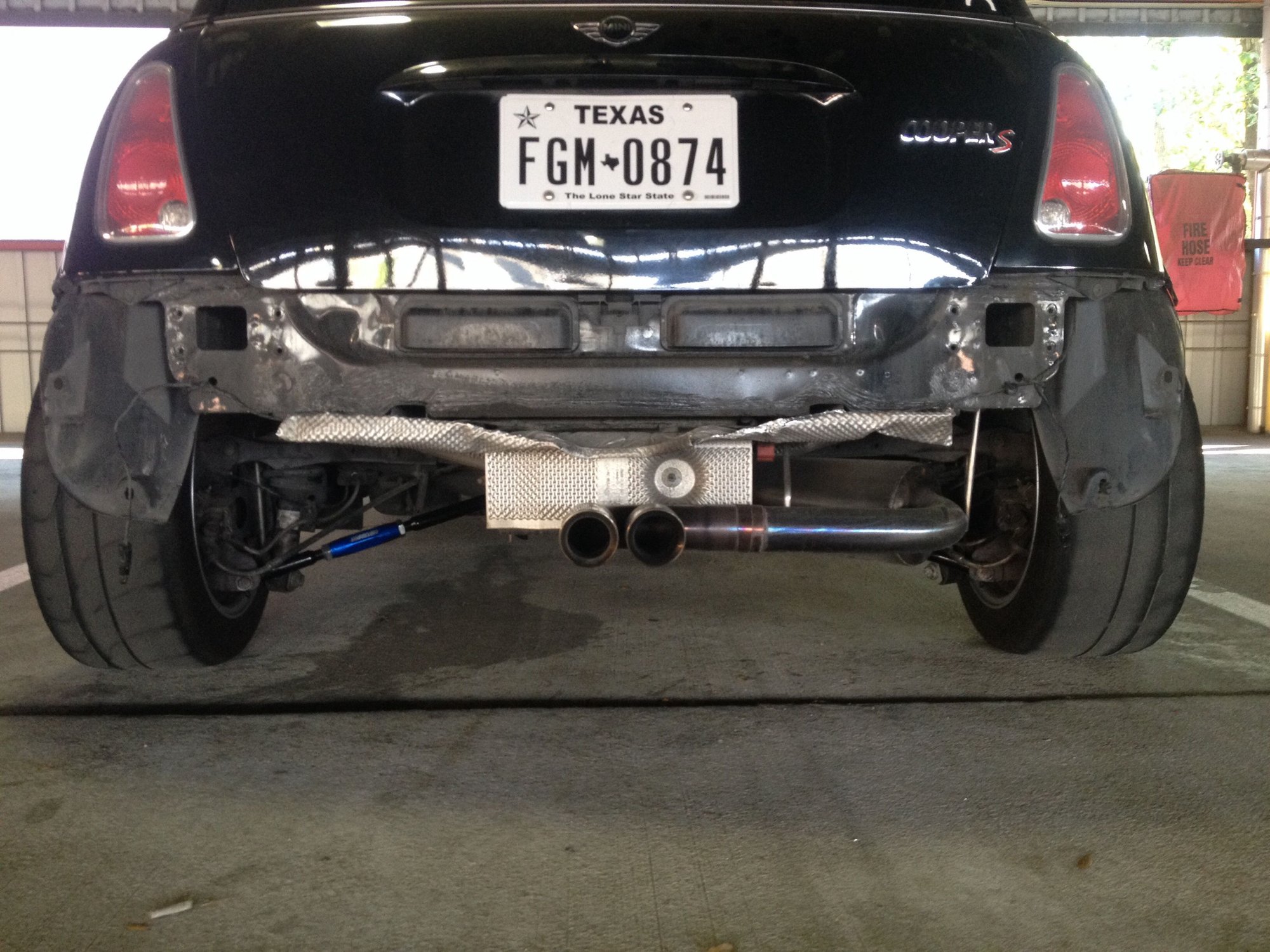

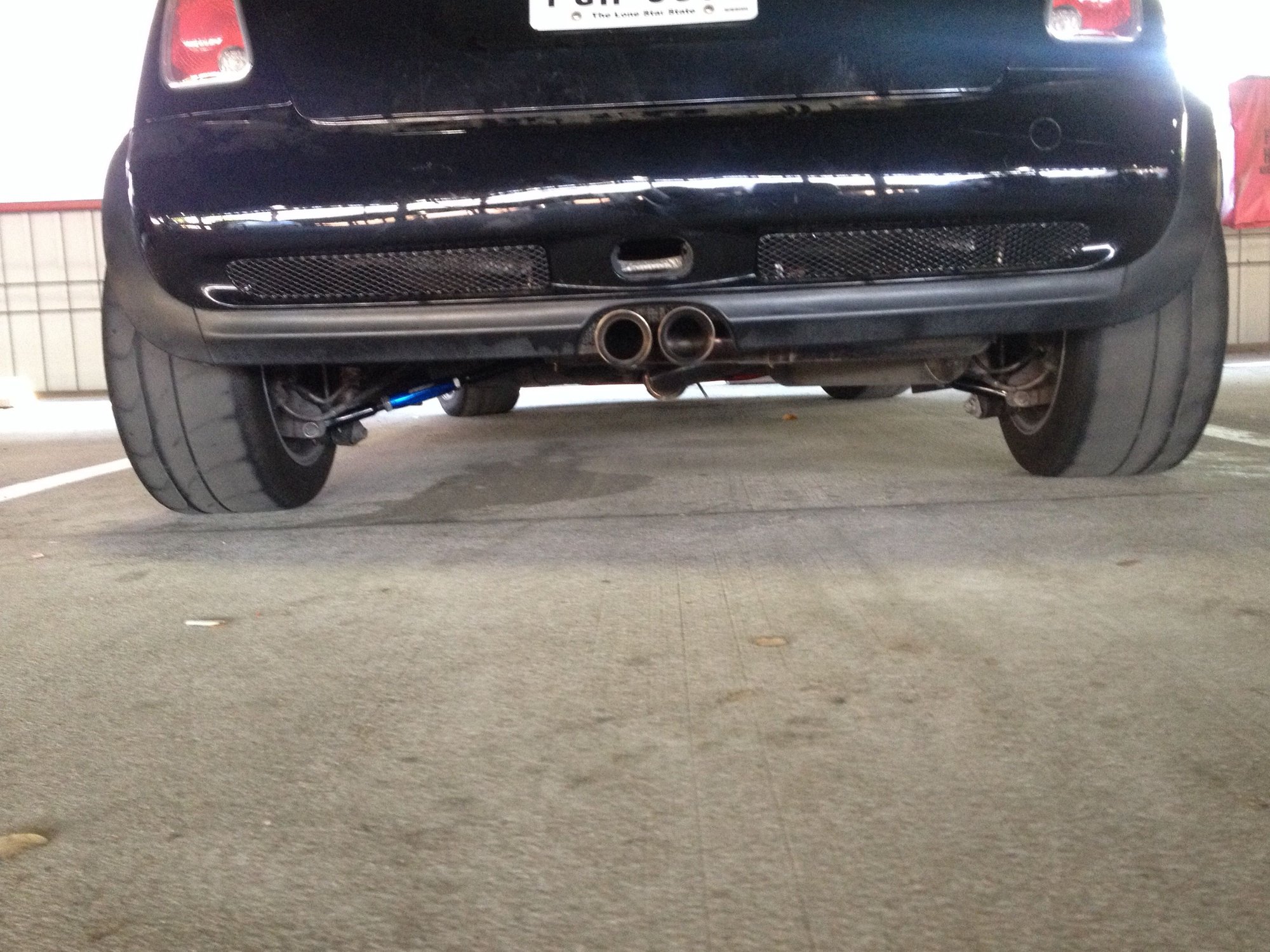

27 March 2016
This weekend I was finally able to get some work done on the car and it feels like it is really coming together now. But there is so much that needs to be done. I have my vision for the ultimate project and it WILL be realized, its just a matter of when and at how much cost. In the meantime I am having a lot of fun and learning a lot. I just wish I could spend more time on the track. For some reason, the build is equally important to me as track time ... something that I did not think would happen.
So this weekend, the Hotchkis rear control arms went in so will be needing an alignment soon but first ... camber plates. Next I installed the brass brake bushings from WayMotorWorks which did more for brake feel than stainless steel lines. The brass bushings will also insure even pad wear.
Next I decided to add a bit to the looks of the car with the hopes of marginal performance gains. Since my car usually runs with some very expensive cars, it could use some TLC in the exterior/looks department.
I saw M7 was having a sale last weekend - if you can call 7pc off a sale - so I picked up their carbon fiber cannards and their 'ultimate' rear grill.
Ever since I removed the stock exhaust I have been worrying about air stacking up in the rear of the car and causing a parachute effect at the rear. My fears went through the roof when I noticed that the stock rear grills are just solid pieces of plastic made to look like grills. The grills from M7 are good quality pieces - I should add they are not actually made by M7 but just carried by them. While heavy sturdy pieces, I don't mind having the added weight over the rear of the car. Install was stupid easy and they look great. I decided to cut some of the heat shield away to further improve airflow. Hopefully this helps high speed stability... or even give me some driver confidence through placebo effect (more likely).
Lastly, the M7 carbon fiber cannards look incredible and are stupid light. I doubt they will do much (other than intimidate others at the track or cut my leg now and then) because the angle of attack isn't very steep, but they look incredible! They are held on by sturdy 3M tape, but I opted for the optional mounting hardware since it will be a track element. I should add that even if you are only streeting with these cannards, you should still use hardware or some sort of fasteners because carbon fiber makes for very sharp and dangerous road debris not to add the sting of losing an expensive piece of bling off your car.
