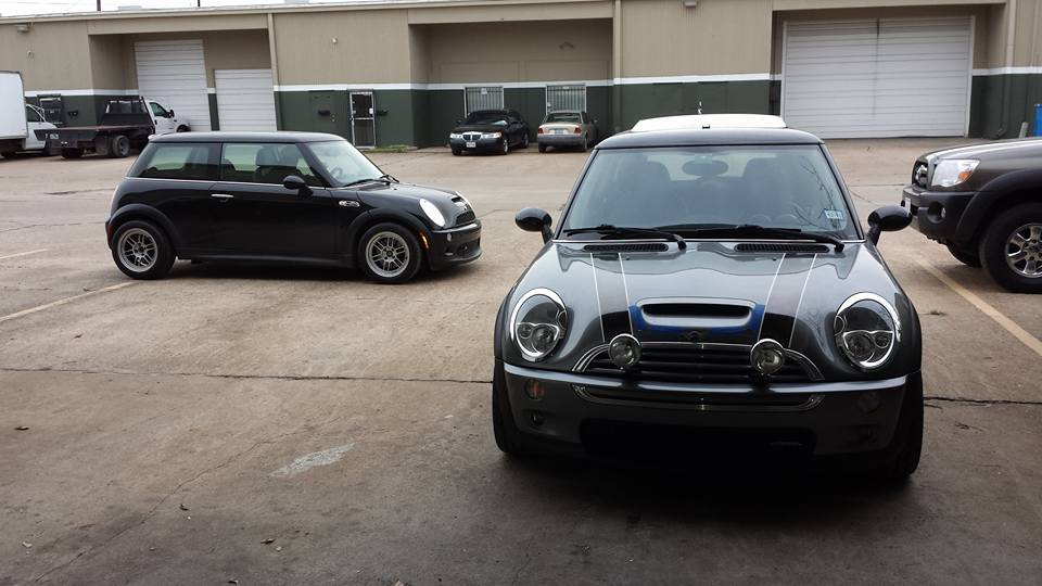

Please don't jump on me here but I went with basic brembo rotors and Hawk HP+ pads as this setup was in my budget. Next time I promise I will go with the carbotechs. I know I can safely get around GransportSpeedway with HP+. There are only three heavyish braking zones and if your brakes are going you can get off the throttle early in one of the braking zones and just coast thru it and hit similar times. One is a 95 -> 80mph the next is like 70 -> 50 and another 90 -> 80. (its a short technical track I only hit like 95).
Anyway next track day is this Sunday Jan 10 and the weather is looking perfect. Temps just barely in the double digits, sunny and 0% chance of rain.
This weekend I stopped in to see NAM member sssevita's garage here in Houston. Its a gnarly place filled with mini cooper parts and vintage scooters. You can see our cars below. He has a really great track set up and I look forward to hitting the track with him. He runs zimmerman rotors with EBC yellow pads. Unfortunately this weekend he will be going to Texas World Speedway while I will be at GSS.
Anyway this month is my birthday so I think there will be some more goodies rolling in.
I still need negative camber its ridiculous so I will be getting the vorschlag plates up front also I am looking at way motorworks' race front sway bar bushings and control arm bushings. Slap it all on and go get a good alignment. Still need SS brake lines and a race seat would really be the icing on the cake. I am looking at the Sparco Evo package just bc its such a simple plug and play install option. Any suggestions on race seats?
Attached Thumbnails Rennfahrer's Barely street legal track toy build-nam.jpg

Update: So I spent all of Saturday hand wash and waxing the car including windows and running other errands that I never got around to installing the brakes which was the most important thing to do. So I really got my moneys worth out of this last set. Even with the car all waxed and looking gorgeous and with the great weather I forgot to take a pic. I'm a potato.
Weather was on the cold side for Texas at around 48 deg and there was some wind coming off the Gulf that made it seem colder.
I ran with the Bronze group which included a Porsche Cayman, a Lotus Elise and a 700HP dodge muscle car. I was able to keep ahead of all, tho catching the Cayman proved to be the hardest. The muscle car was surprisingly capable in the turns given its heft and the driver was nice enough to lift on the straights to let me by.
They did not run a Silver group and the Gold group included a Corvette owned by the honey badger himself with Stoptech brakes larger than my wheels, some sort of Mercedes AMG that I think might have been grandfathered in and a take no prisoners Lotus Elise that I could not take my eyes off. Thing had tons of Carbon aero bits, a supercharger giving it 300HP gorgeous carbon race seats and an experienced driver who was doing 1min flat laps.
We ran in a clockwise full track configuration which is rarely done at GSS and I have only done on a sport bike so I took my time to learn the new line. I could easily have been bumped to Gold but considering my ancient brakes and that I needed to nurse the tires I opted to run a bit slower and show my friend in the lotus the line I was using.
I did not run a lap timer as the main point of the day was to have fun and see how the car handled with the new sway bar and bracing on. I know the Lotus was running 1:13s and I was several seconds faster. I would guess I was doing under 1:08. Based off his pace.
The instructor, owner of the dialed in Lotus pictured below, also did a ride along and said I was 90% of the way there. I like to think by 'there' he meant pissing excellence. But who knows.
I had the Hotchkis bar set on the medium setting and could have used a little more. Next track day I will run stiffest setting and see how that goes. The bracing added a more planted feel to the car. Particularly in the low speed stuff and a very fast change of direction low speed esse section.
I dont know when I will have the time but I need to get my new brakes put on. I also ordered a set of stainless steel lines from Detroit Tuned which should be here later this week. Madness has still not shipped my oil cooler, though it will be a couple more months before I really need it.
I have to do bullcrap family stuff for this coming holiday weekend so I wont have any time to work on the car. I am debating just dropping it off at a shop :/
Anyways thank you guys for all the pointers and interest. It really helps keep this project on the right track.
Attached Thumbnails Rennfahrer's Barely street legal track toy build-lotus.jpg

Ah what a beautiful Lotus. I drove an Exige once. Was such a perfect size for my frame/build. What I would give to track one of those beasts one day. Hopefully he gave you some good pointers when he did the ride along. That's the thing about being a self taught driver is that you become appreciative of those willing to give you pointers and advice. I take whatever I can get. Have you done any bushing upgrades to the MINI yet? Or are you still running with the stock rubber ones? Seems like you're doing well out there so keep it up.
888.280.7799 | 6am - 5pm PST
Old Jan 11, 2016 | 01:20 PM
  #100
Rennfahrer555's Avatar
Rennfahrer555
Joined: Oct 2007
Posts: 280
Ha yes he was able to point out two turns where I needed to be apexing later and then showed me a different way of going thru the sweepers. I am not sure which way was faster but would like to explore if I had better datalogging. My way felt smoother but his felt faster but that is just the buttdyno-gps-gforce-majiggy ... but smooth is fast right ??
Yes I have WMW race control arm bushings and some powerflex race sway bar bushings on the bday list. Will see if my friends and family pull thru
