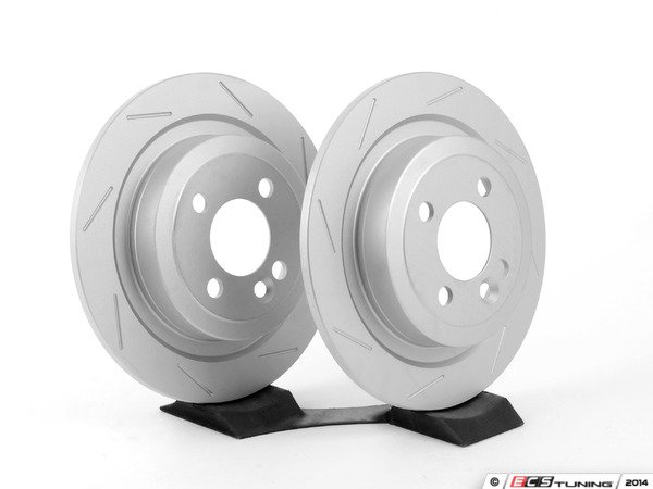

Here is all the parts in are kit , plus comes with new brake rotor screws, one for each rotor. This kit comes with NON cross drilled / slotted OEM MINI front rotors, Crossed drilled / slotted was an optional upgrade.
2009 MINI Clubman JCW
http://www.ecstuning.com/Mini-2009-Cooper-R55-John_Cooper_Works_Clubman-Coupe-L4_1.6L_N14B16C/Braking/Service_Kits/ES2804299/
Other Options : That use or ECS Geomet rotors.
