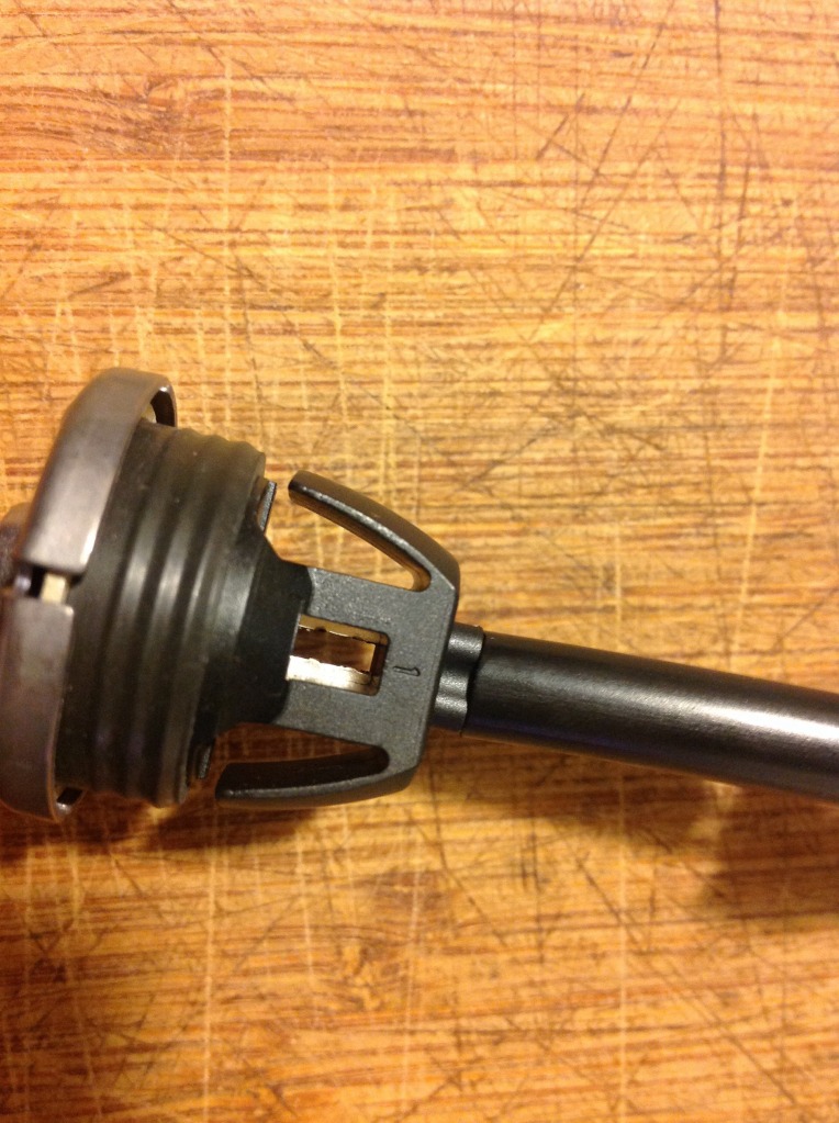

So no oil at the oil solenoid?. My cars DME was going crazy until I replaced the solenoid valve and cleaned up the wiring harness with electric contact cleaner. Been running great for the last 5,000 miles.

Do u have pictures?

Yes. Top photo solenoid valve with exterior wire full of oil. Also valve was very loose and parts could be spun easy. Bottom photo is MINI's fix wire I did not use. My car is an early 2013 and they released a updated valve 3 months after my build date.

Just to give a update on my 09 jcw, we changed out the oil soaked harness and the problem went away
