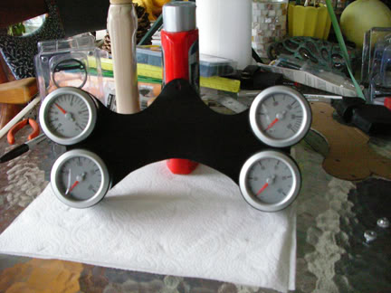

I made my own gauge mount from some scrap 1/8" aluminum and 2" ABS drain pipe.
I have a boost/vacuum gauge, an oil temperature gauge, a water temperature gauge and an oil pressure gauge. I find that the oil temperature gauge tracks the water temperature (within 10 degrees)
I have been thinking of getting a water/meth system, and would replace the oil temperature gauge with the meth system gauge.
I have Mashall gauges, they have gauge faces that match the MINI tach and speedometer exactly, they use Autometer senders. I hooked them up with Cravenspeed gauge adapters.
