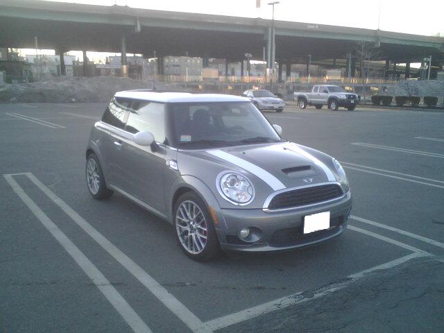

Attached is a pic of my rig that I snapped with my BBerry.

Nice painted fenders, how did you do that?

@bford100:
Thanks!
I actually opted for the factory installed aero kit vs. the JCW aero kit. The factory kit comes with the painted fenders, and it was cheaper!
