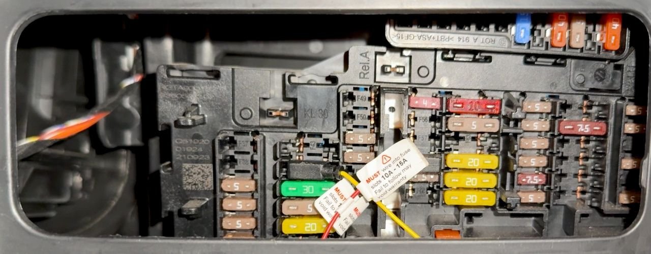

Here's a photo of the fuseblock on my 2022 F57, with both a dashcam and a blind spot detector professionally installed.
2022 fuseblock with dashcam and blind spot detector

Awesome! Thanx!! I ended up using the empty slot above where you're installer tapped into with the yellow wire and the empty slot above the 3 yellow fuses on the right. Everything is working great!
