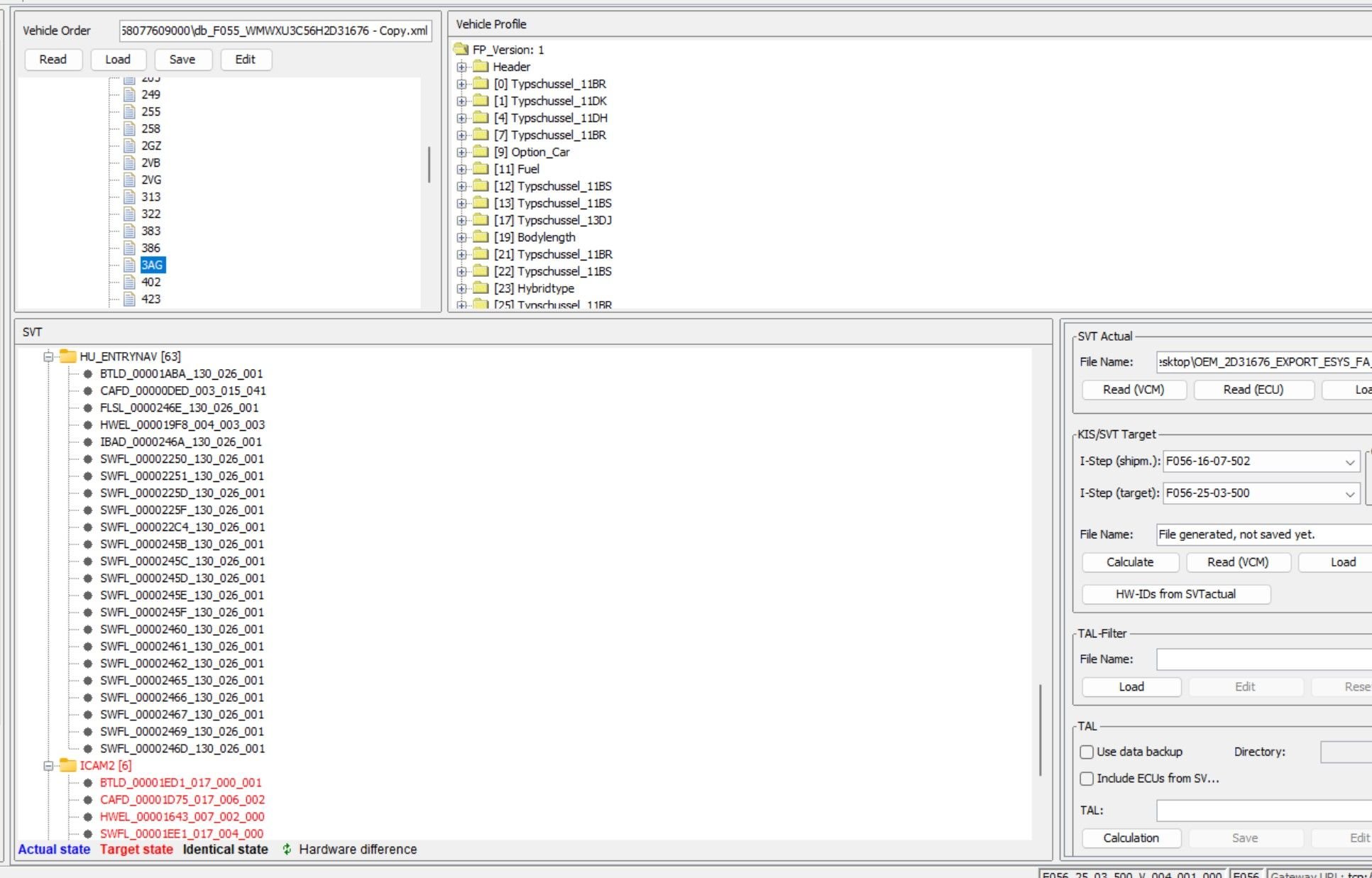

Have to use your VIN to calculate 3AG, Please give me your VIN number.

WMWXU3C56H2D31676

HU & BDC looks ok to support 3AG

You Entrynav1 HU support TRSVC on Pin 21 23 24, you can connect OEM camera or 3 party camera to HU.
