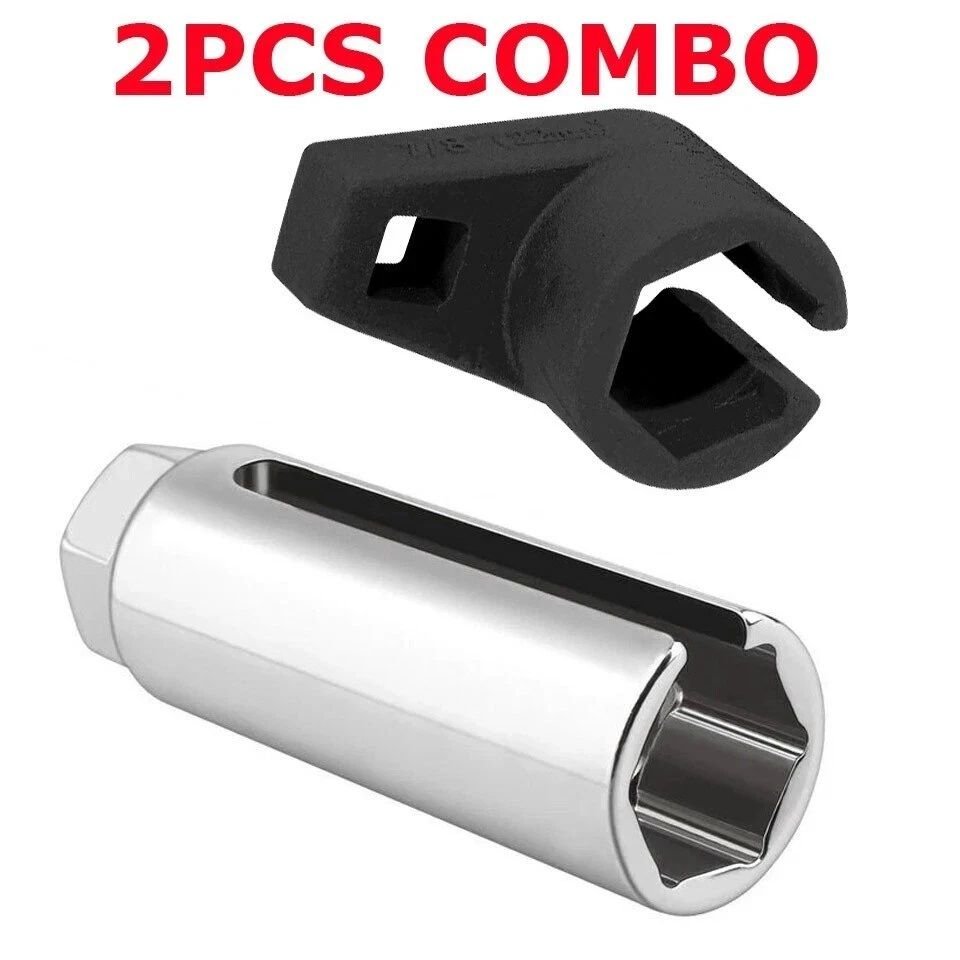

Just wanted to come back and share my experience for anyone trying this for first time. I was getting some knock and generally really crappy idle so I checked with Bimmerlink and it called out the upstream oxygen sensor. I watched a couple of videos and it looked daunting. Turns out the hardest part is just removing ALL the plastic bits in the way which is pretty easy. I didnt want to remove the Air intake pipe if I didnt have to because as my car is a 2014 most of my plastic clips are brittle and any plugs or connections crack when I try and undue them.
I was able to undue just a couple of clips and the large circular one where it connects and didnt have to remove any of the electrical connections. Its a little tight but you can get to the upstream oxygen sensor. In hindsight I should have replaced the downstream while I was there and its actually a little easier to access.
The upstream is angled in such a way that it was difficult to get the longer oxygen sensor tool and ratchet head to fit so I am glad that I bought a kit that had to different tools and the offset one fit fine. After watching some videos I thought that the sensor would be a bear to get out and was prepared to use my 2 ft cheater bar to get it out but .. It turned effortlessly and I am wondering if that was the problem as there was no way that that was tightened to 50nm.
Put a bit of grease of the threads of the new one and it goes right back together.
