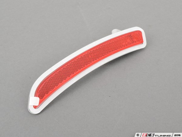

My rear drivers side side marker light is out.
Am I correct in that the front and rear side marker lights, the ones along the wheel arch trim pieces, have to be fully replaced when the light goes out? There’s no individual bulb I can buy to replace the burnt out one with?
I pulled back the wheel well lining and look at the unit and it seems that the plug connects to the entire red housing, which I’m assuming is sealed with the light inside of it.
Anyone have any experience in dealing with a burnt out bulb in one of these?

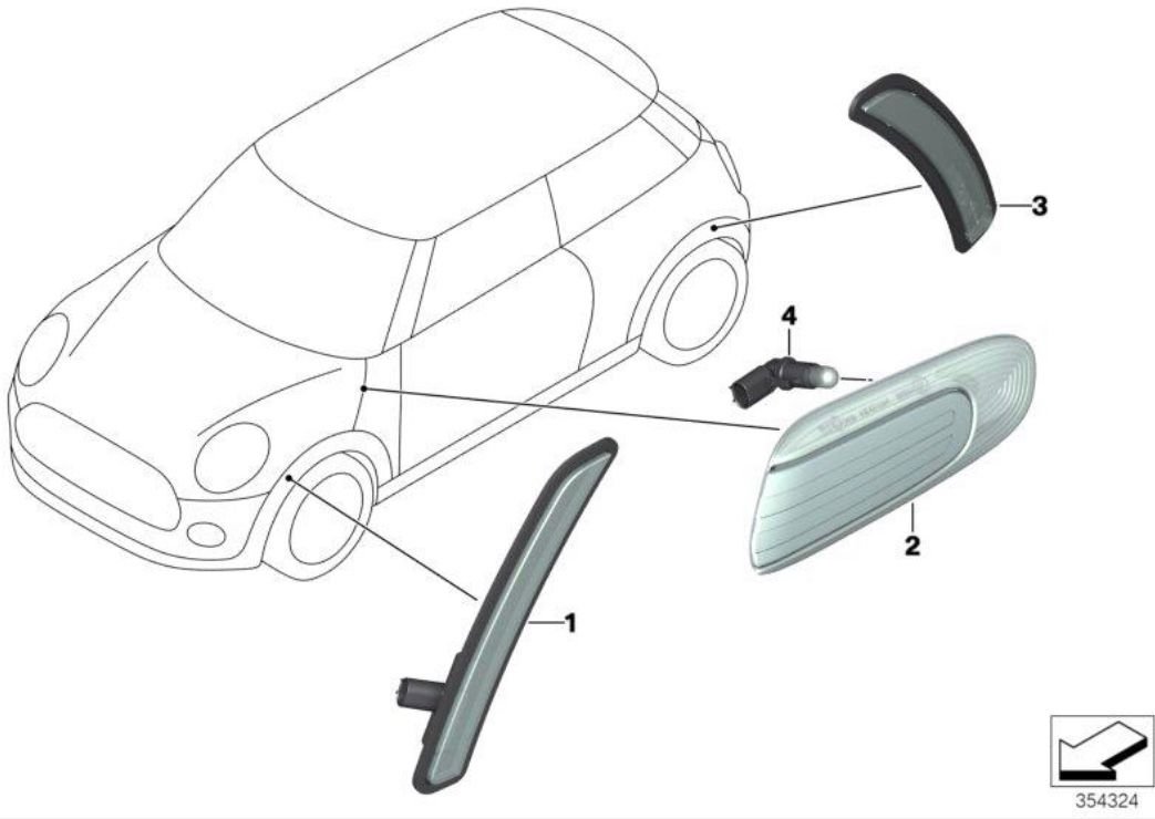

I’m not seeing anything that twist. It’s a simple connector that plugs into the back of the light housing. Makes me think that the entire unit needs to be replaced vs being able to simply change the bulb.
If you look at a parts diagram it doesn’t show a bulb fitment for the front and rear markers but it does for the side turn signal marker.
I’m perplexed. lol

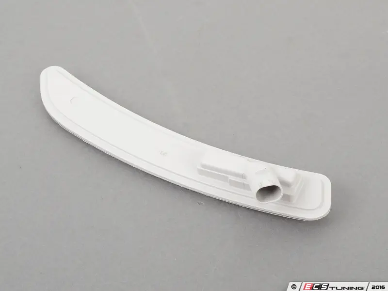

Its LED for the F56+ MINIs, so either it failed or the wire or circuit is damaged. Its all one piece.
https://www.ecstuning.com/Mini-2014-...ng/Indicator/2

The whole piece at $40!!
But check the connector first, also that you are getting 12V at that connector, before getting one.

They have double sided tape holding them in.
Use a hair dryer to soften tape, push away.
New one has tape already installed.

Hi @JJackie07, the front left side marker part number is 63137298337. It takes about five minutes for removal and installation. You can use a heat gun/hair dryer like @TVPostSound mentioned or on a hot day park the MINI in direct sunlight for about 15-20 minutes and push the marker inward to remove.
