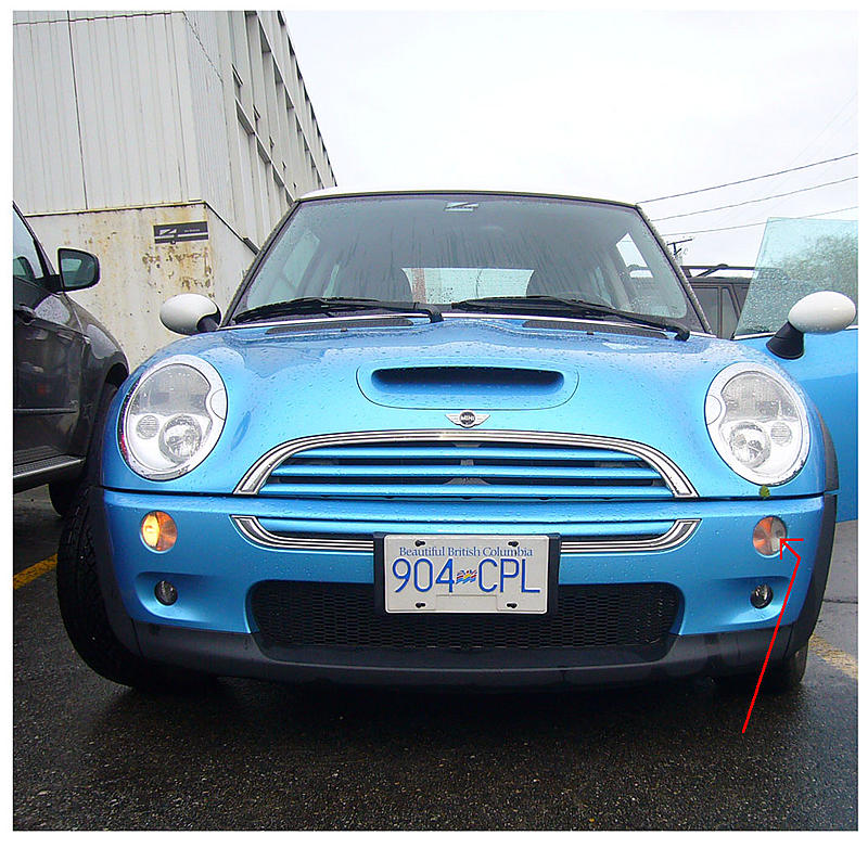

dumb question, but I need to change a marker light on my '03 MCS and I couldn't see how to get the bulb out. I did get the connector off (as well as some skin off a few knuckles), but how the bulb itself comes out was not obvious to me.

Once you get the wheel well liner removed, you can access the marker light from the rear. The socket holding the bulb turns lefty loosey I think, then you can pull the bulb/socket out.
There is a rubber o-ring on the socket, that seals it inside the housing. Depending on how old it is, it can be quite hard to loosen.

The bulbs in the running lights (pictured in the first post) and in the wheel arches are 194 style wedge bulbs. Pull them straight out (no twisting).

Oops, yes. The bulbs pull straight out. I thought he meant the bulb housing, sorry.

I thought it was a no-brainer to simply pop the grill that the light is in out of the body panel. No need to reach behind the body panel.

It definitely is done from behind, not sure if BMW was thinking this would deter theft or what.

after more skinned knuckles (and a healthy slather of WD40) the light popped out no problem, and it was definitely from the back.
